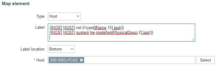

    I have done a Map Element where my label uses macro to show an Interface Name and hardware Model of a Network Switch.
    Click image for larger version  Name:	zabb1.JPG Views:	0 Size:	30.8 KB ID:	434117

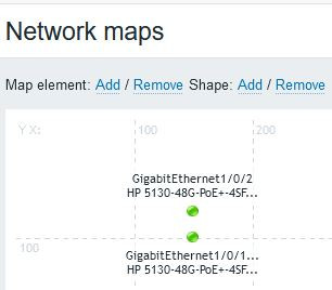

    it works for interface number 1/0/1 to 1/0/9 but when i have a value 1/0/10 i have 1/0/1...
    Also for the hardware model i don't have the full value also finishing with ...
    Click image for larger version  Name:	zabb2.JPG Views:	0 Size:	17.2 KB ID:	434118
    How can i have the full text value ?

      Thanks a lot i found it on '/usr/share/zabbix/include/items.inc.php'
      change 20 to 100 on this part :
       // apply value mapping
      switch ($item['value_type']) {
      case ITEM_VALUE_TYPE_STR:
      $mapping = getMappedValue($value, $item['valuemapid']);
      // break; is not missing here
      case ITEM_VALUE_TYPE_TEXT:
      case ITEM_VALUE_TYPE_LOG:
      if ($trim && mb_strlen($value) > 20) {
      $value = mb_substr($value, 0, 20).'...';
      if ($mapping !== false) {
      $value = $mapping.' ('.$value.')';
      break;
      default:
      $value = applyValueMap($value, $item['valuemapid']);
      return $value;
