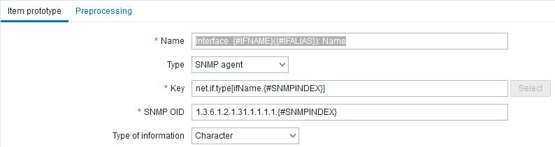

    I have an item prototype with the Ifname value of my switch interface
    Click image for larger version  Name:	zab-item1.JPG Views:	0 Size:	28.3 KB ID:	434171
    So i have for the interface 1 of my switch the value GigabitEthernet1/0/3 and i created a value map who transform GigabitEthernet to G to have G1/0/3 in result. It works but when i want to use this in map label using {{HOST.HOST}:net.if.type[ifName.2].last()} i have this on the map :

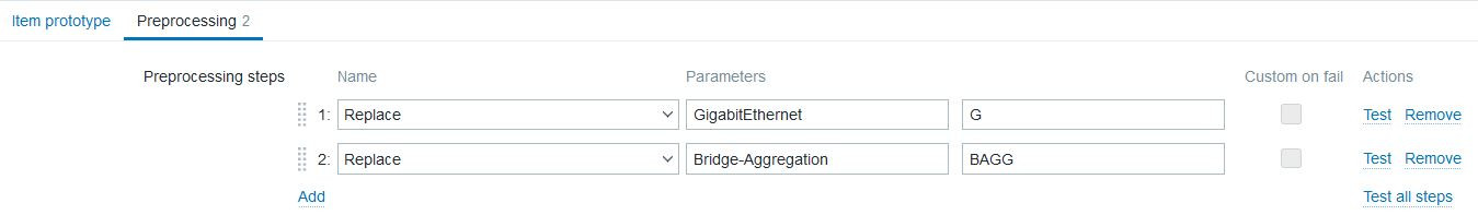

    I found how to do it. i use the the Preprocessing on item prototype :
