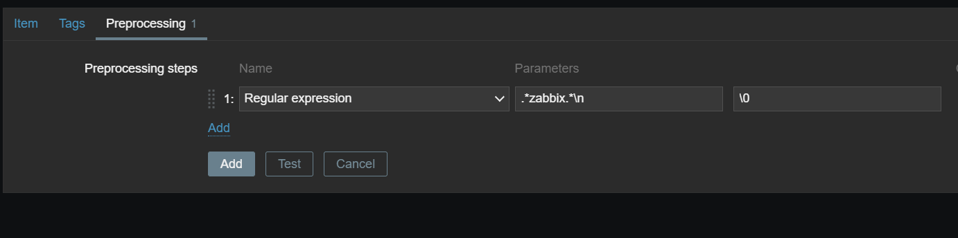

      Here is an example in action. I created an "SSH agent" item, with "netstat -t" as executed script.
      Then, I go to the preprocessing tab, and create a regex to get me only the first zabbix connection

      Then, thats the result
