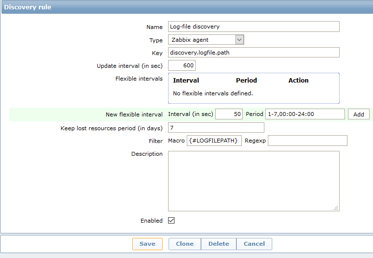

    There are attachments show my discovery configuration:

    I think you have to make the array a value with a key of "data".
    print json.dumps({"data": data})
    so it produces...
    { "data": [{"#LOGFILEPATH": "/opt/logs/projects/cms/cms.log"}, {"#LOGFILEPATH": "/opt/logs/projects/books/nginx.log"}] }

      Another one mistake: macro {#LOGFILEPATH} should be in brackets {}
