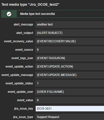

    • cmendoza
      • Nov 2021
      Here is a screenshot of when I use the password but when I try to use a Token it fails.

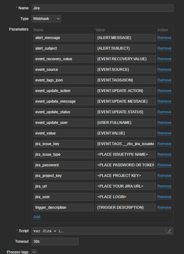

      • cmendoza
        • Nov 2021
        The jira web hook does have <PLACE PASSWORD OR TOKEN> in the jira_password field parameters. I will be disabling the login for this API login and will need to use a token.
