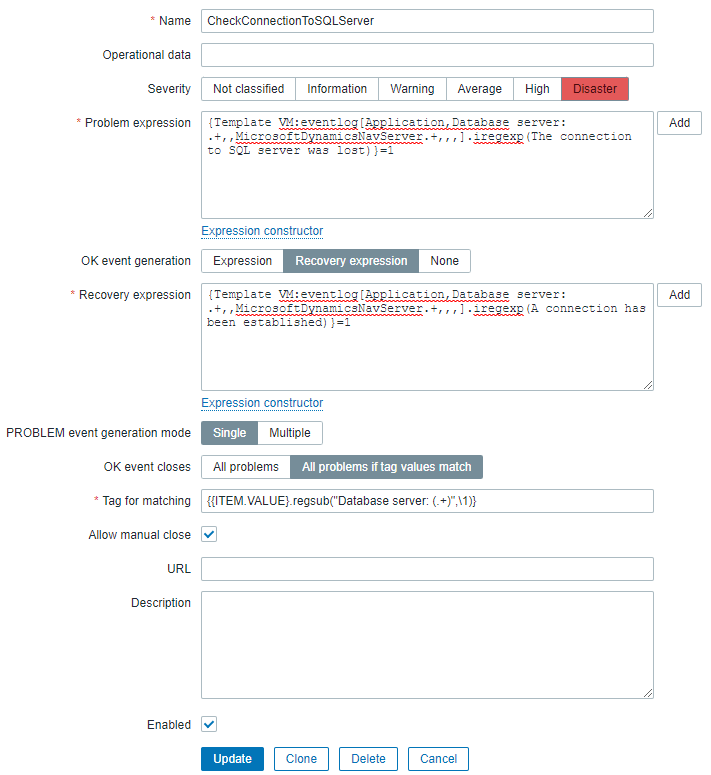

    I've been attempting to create a trigger that would warn me when a host loses connection to a SQL database and would also automatically resolve when the connection is restored.
    After reading the documentation, the following article seems to cover exactly what I need: 1 Trigger-based event correlation [Zabbix Documentation 5.0]
    However, despite following the example specified in the article quite accurately, I'm unable to get these problems to auto-resolve.
    Here's the example in the article:
    Here's the trigger I've created:
    Click image for larger version  Name:	trigger.png Views:	0 Size:	42.6 KB ID:	434593
    Tags:
    Click image for larger version  Name:	tags.png Views:	0 Size:	10.7 KB ID:	434594

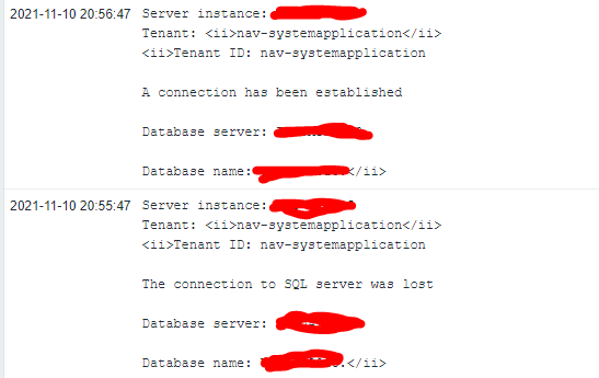

    Unfortunately, while I can quite easily get the problem to trigger, it never goes away after seeing the "A connection has been established" message in the event log.
    I can confirm that the item that monitors the event log for Information messages definitely received the message successfully and the timestamp is newer than the error message.
    Shouldn't the recovery expression auto-resolve the problem as soon as the expression conditions are met?
    Should I be using the same item for both the Problem and the Recovery expression for this to work?
    I'm on Zabbix server 5.0 LTS with Zabbix agent 3.0.0 running on the host, if that makes a difference.
    Thank you in advance for the advice.
    UPDATE: I've tried to use the same item for both the Problem and the Recovery expression and the issue remains:

    Could you please clarify if tags are properly populated when problem raised? And does it properly close alarm if you not use tags for closing while using same item in problem and recovery expressions?
    I did something similar with tags in 4.x and it works fine.
    • xenograft
      • May 2021
      • 10
      Thank you for responding!
      The tags are definitely populated correctly - I get a "SQL" tag and a tag with the database server name next to the problem.
      The event that *should* trigger the recovery expression also contains the database server name, so it should have no problem generating a matching tag (I checked with regex to be sure).
      Removing the tag matching from the trigger unfortunately did not work either...

        Trigger configuration:

        At the same time, I don't see any obvious mistake on your screenshots. Not sure what exactly the issue you facing.

            In single problem generation mode it works just fine as well. Also, instead of using single mode event generation, which pretty much would fail to create a 2nd problems for you if 2 or more servers will have issue same time, you can add global event correlation rule on top of trigger setup to clear duplicates(also first need to figure why trigger fails).
            If you can - share the original recovery log message from event log. In my tests I manually typed both regexp in Zabbix and text in SNMP Trap. In your case they come from different sources, so maybe there is some minor differences. I'm really at loss over your problem atm.
