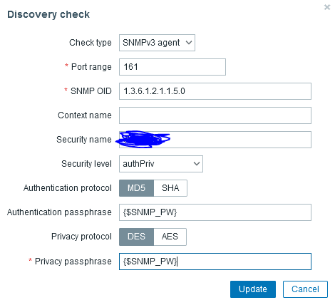

    we wanted to get a SNMPv3 discovery to work, but we are facing some issues right now.
    At the moment we are thinking that there are some problems occuring during the authorization & encryption part.
    We tested trying to use SNMPv2 to discover our MikroTik-routers which seems to work just fine but with SNMPv3 we get disconnects every 20 minutes and thats if the discovery actually works.

    :Click image for larger version

    Any suggestions we could try?
