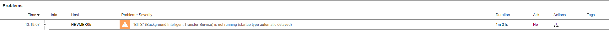

    Zabbix is reporting this:

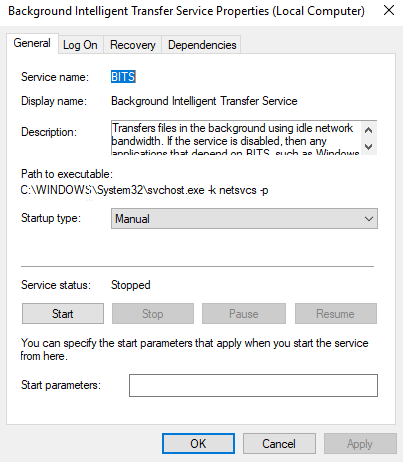

    But on the host the service is set to manual. Weird.

    • 5002
