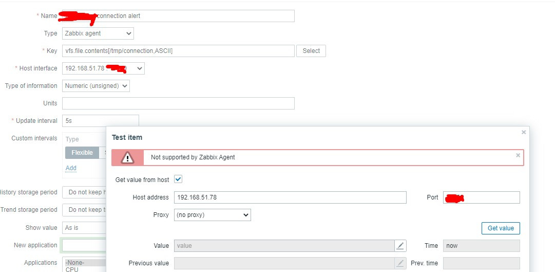

      Hi Tikkami,
      i tried that one configure item and the trigger.
      trigger test is okay but agent item I am having error
Name:	zabbix alert.png
      Error is test item
      -unable to get teh value, its says NOT supported by ZABBIX agent
      • tikkami
        • May 2018
        • 71
        Which user has been used to run zabbix agent?
        Does that user has permission to read the file?
        • vershooter
          • Nov 2021
          zabbix iser, as checked on ps -ef | grep zabbix
          Yes I change the the owner to zabbix and I also change the permission to rwx in user, group others
          • vershooter
            • Nov 2021
            Hi All,
            Can anyone help me. Thanks
            • tikkami
              • May 2018
              • 71
              Must be still some issue with file/folder permissions. Try e.g. /tmp.
              • vershooter
                • Nov 2021
                tikkami
                Still same,
                I tried to put the file in /tmp
                -rwxrwxrwx this is the permission of the file.
                • tim.mooney
                  • Dec 2012
                  • 1436
                  Are you using SELinux, AppArmor, or some other security mechanism on the client where the agent is running?
                  • Atsushi
                    • Aug 2013
                    • 2028
                    What version of Zabbix agent are you using? Are you using a version of the agent that supports vfs.file.contents[]?
