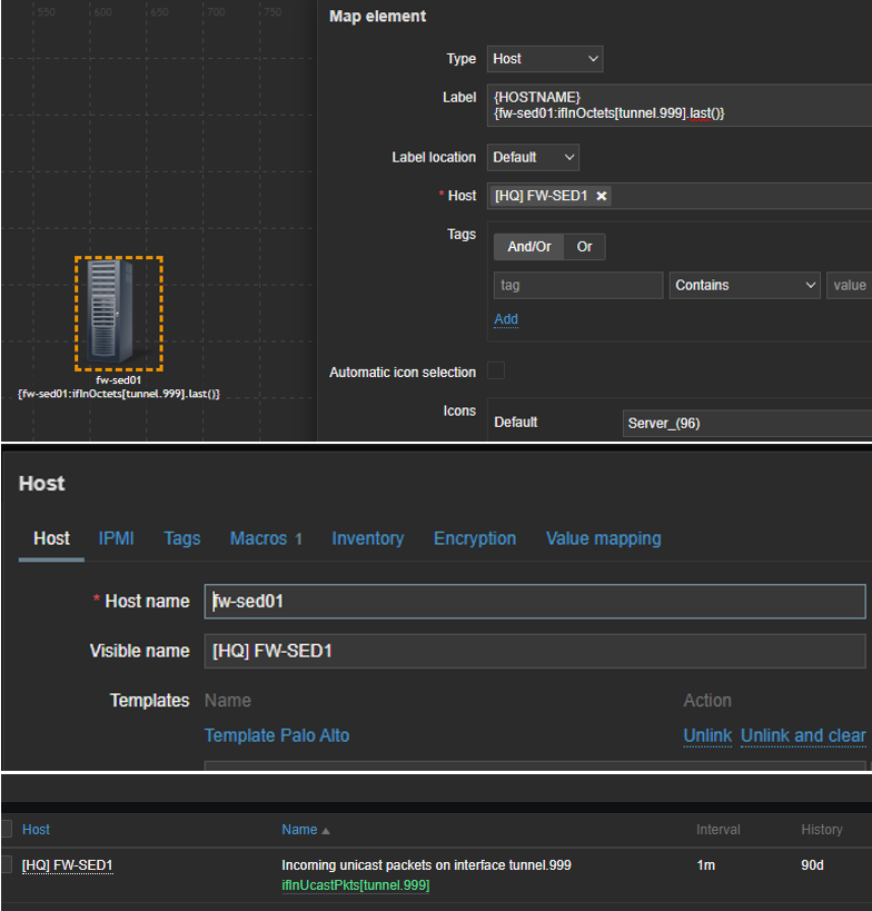

    I'm testing Zabbix (6.0 alpha7 appliance) and I want to show the live data of the devices (routers) in the label on the maps.
    I have set the "Map element label type" on the maps to Label.
    I tried different syntaxes but none of them worked. Do I have an error in the syntax or do I have to adjust a setting?
    {HOST.NAME} << works
    {HOST.CONN} << works
    {{HOST.HOST}:icmppingsec.last(0)} <<< don't work
    {{HOST.HOST}:uptime.last(0)} <<< don't work

    I have checked the key under Latest Data, the name is correct.

              I'm doing exacly that.
              See the attachments:
              Has any way of fix this ?

                and you are trying to show ifINOctets item, but your last part of pic shows IfINUcastPkts. I know it may seem like a bit of trolling, but sometimes people really miss obvious things.. Eventho, it should then display *UNKNOWN* on label...

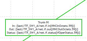

                  • engrnauman
                    • Jul 2023
                    Hello.
                    I'm stuck in this problem. I don't know what to do. I'm unable to solve this puzzle. please help me about syntax or something else.Click image for larger version
                    • Oleksandr Denesyuk
                      Oleksandr Denesyuk commented
                      Hello.
                      Put a question mark before last, for example:
                      In: {?last(/TF_SW1_A/net.if.in[ifHCInOctets.59])}
