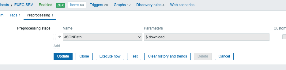

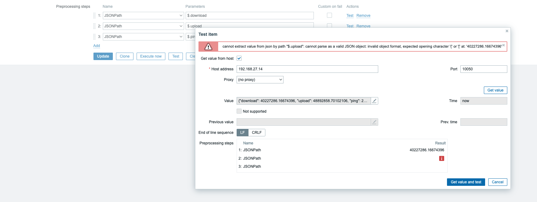

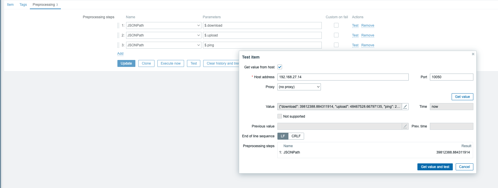

      That's right, I have a script and it works fine, we receive json data.
      2screen. When I download data one by one it is OK
      3screen . The problem arises when I want to download three parameters at once.

      Click image for larger version  Name:	Zrzut ekranu 2021-11-24 o 13.00.21.png Views:	0 Size:	55.3 KB ID:	435433
      2.
      Click image for larger version  Name:	Zrzut ekranu 2021-11-24 o 13.01.27.png Views:	0 Size:	82.7 KB ID:	435434
      3.
      Click image for larger version  Name:	Zrzut ekranu 2021-11-24 o 13.04.48.png Views:	0 Size:	93.0 KB ID:	435435

            Yeah, preprocessing works a bit different.
            You run 1st step preprocessing, it modifies value. Modified value passed to 2nd step preprocessing, it modifies data and passes it to 3rd step, etc...
            So after 1st step is run you have data 4022786.16674396. This data no longer contains JSON, so 2nd step pre-processing fails to find JSONPath you asking for.

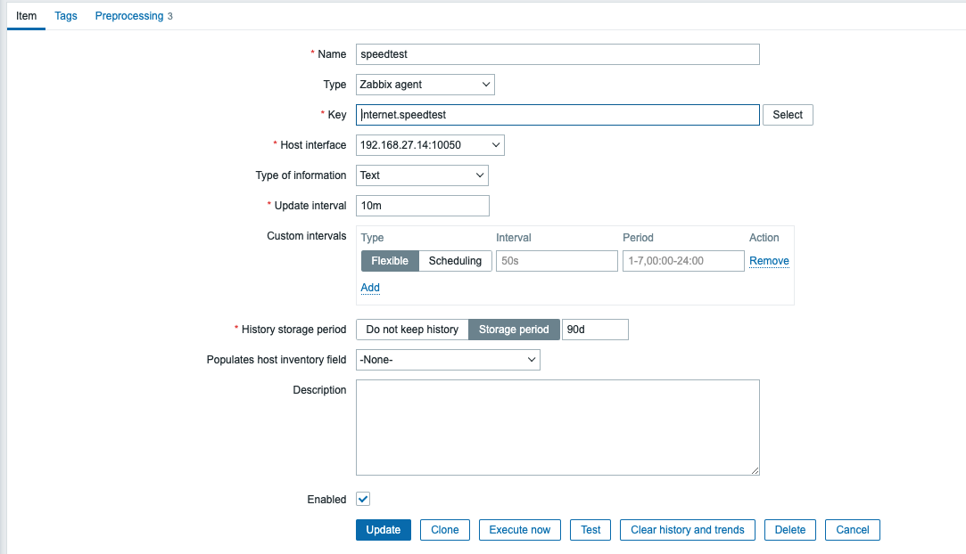

            What you want to do instead: setup 3 dependent item, choosing speedtest as master item. In each of dependent items you setup a single pre-processing step, different one for each item.
            As result you have 3 different items, each have unique preprocessing step representing download, upload and ping respectively.

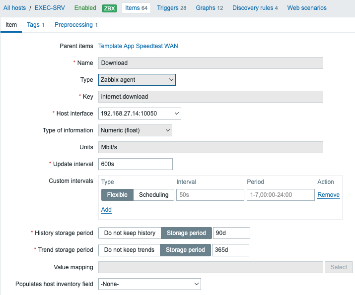

              I created 3 different items for download, upload and ping. This is how I was able to download the data. Thanks for your help, gentlemen

                This was not exactly as suggested, but whatever floats your boat..
                Currently you are doing 3 polls and possibly get 3 different values for each.
                What was suggested is doing 1 query and add "Dependent items" to it. so you would distribute values from that one query to items and they would be acquired from same session.
                you should probably have a bit more colorful picture.. Did not bother to make triggers..

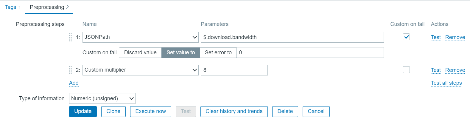

                      2.editing the config agent file on windows and add
                      UserParameter=speedtest.download,powershell -command C:\Users\cdr\test.bat ; Get-Content 'C:\Users\cdr\speedtest.json'
                      now my problem is get all values as keys.

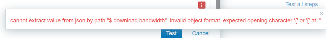

                      Click image for larger version  Name:	image.png Views:	0 Size:	37.8 KB ID:	471530​
                      Click image for larger version  Name:	image.png Views:	0 Size:	53.2 KB ID:	471532​
                      Click image for larger version  Name:	image.png Views:	0 Size:	23.6 KB ID:	471531​
                      ​here I'm not clear how to solved.

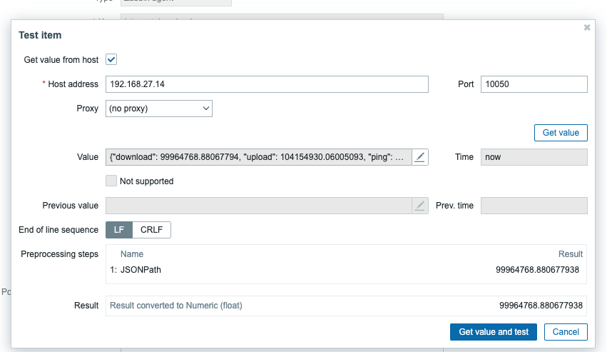

                        Maarguello, I think you are using the wrong Preprocessing parameter
                        use this to find the right key
                        in my case it looks like this and works
                        Download:
                        TEST
                        Preprocessing
                        I also get the speedtest data from the json file

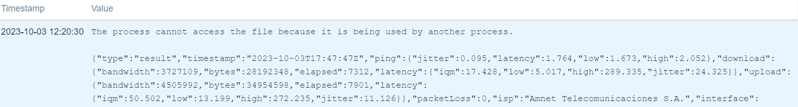

                          Notice the "The process cannot access the file because it is used by another process." ?
                          That seems to be part of you return value, which in turn screws it up being a proper json... Find that reason you have it there and after that you may succeed...
