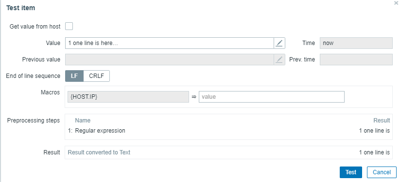

    I am having trouble with regex preprocessing only matching one time and then stops matching. Seems like zabbix is not using /g modifer for regex

    This matches everything until "is" on each line. Here is regex101 link also: https://regex101.com/r/NicKyj/1
    So group 1 should be all those matches.
    But in zabbix when I test in preprocessing it will only match the first line. See the image:
    Is it possible in zabbix to return results from each line in this case in preprocessing ?

    Yes, it returns only one match. 1 item, 1 value....:P What would be the usecase of returning multiple?
    If you need data manipulation, use javascript. Or your source should return already prepared data, so no manipulations are needed.

      Yes the usecase would be to manipulate data - to remove few constantly changing values and as next step in preprocessing use discard unchanged against the remaining data.
      But then it is clear, must learn and create a small javascript most likely.
