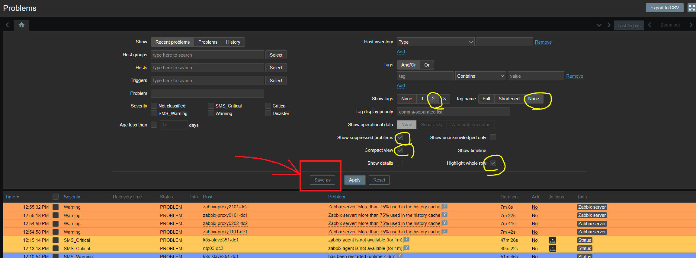

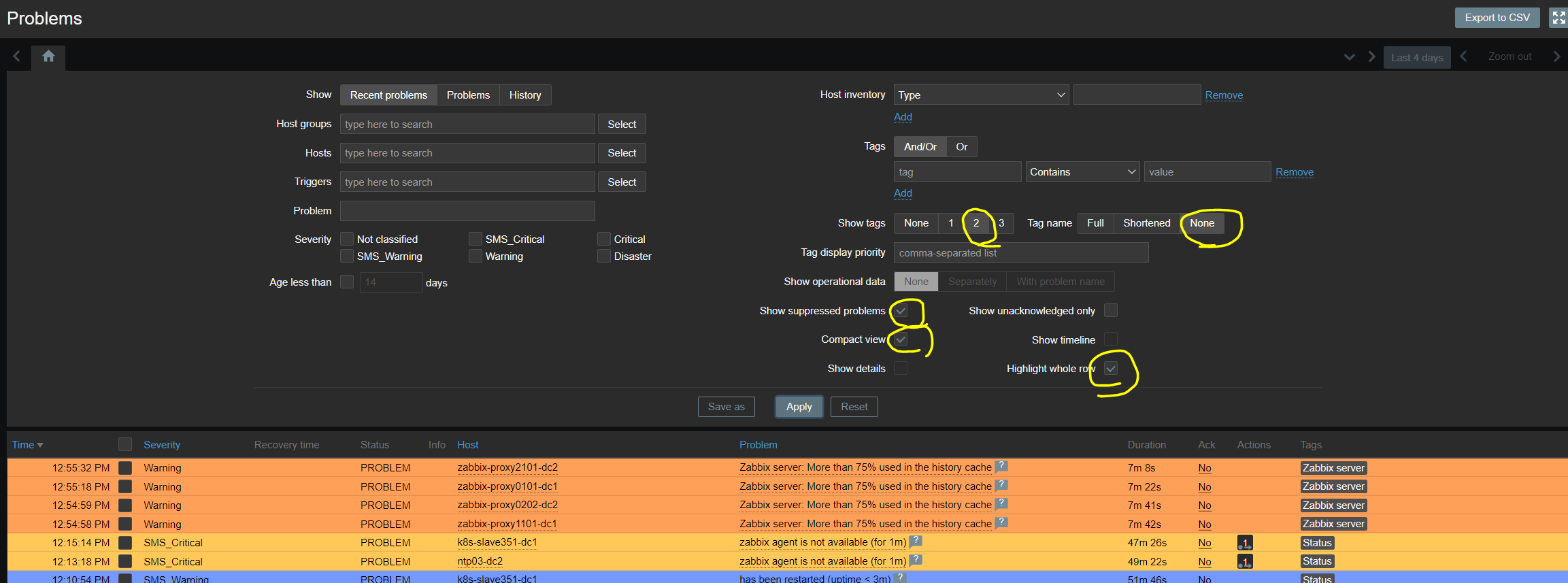

    Hi users!
    I am a enthusiastic user of zabbix in Korea.
    Whenever I enter the Monitoring > Problems page, the filter setting is initialized.
    I want the settings that I checked to remain checked.
    (I want the parts shown in the image below to be checked.)
    Is there any way I can maintain this setting?(every time i enter this page)
    Please tell me if you have one.
    Thank you!

    Click image for larger version  Name:	image_20682.png Views:	0 Size:	140.3 KB ID:	436221
    Read this: https://www.zabbix.com/documentation...vorite-filters

      oh it works!! thanks!
      FYI : https://support.zabbix.com/browse/ZBXNEXT-710
