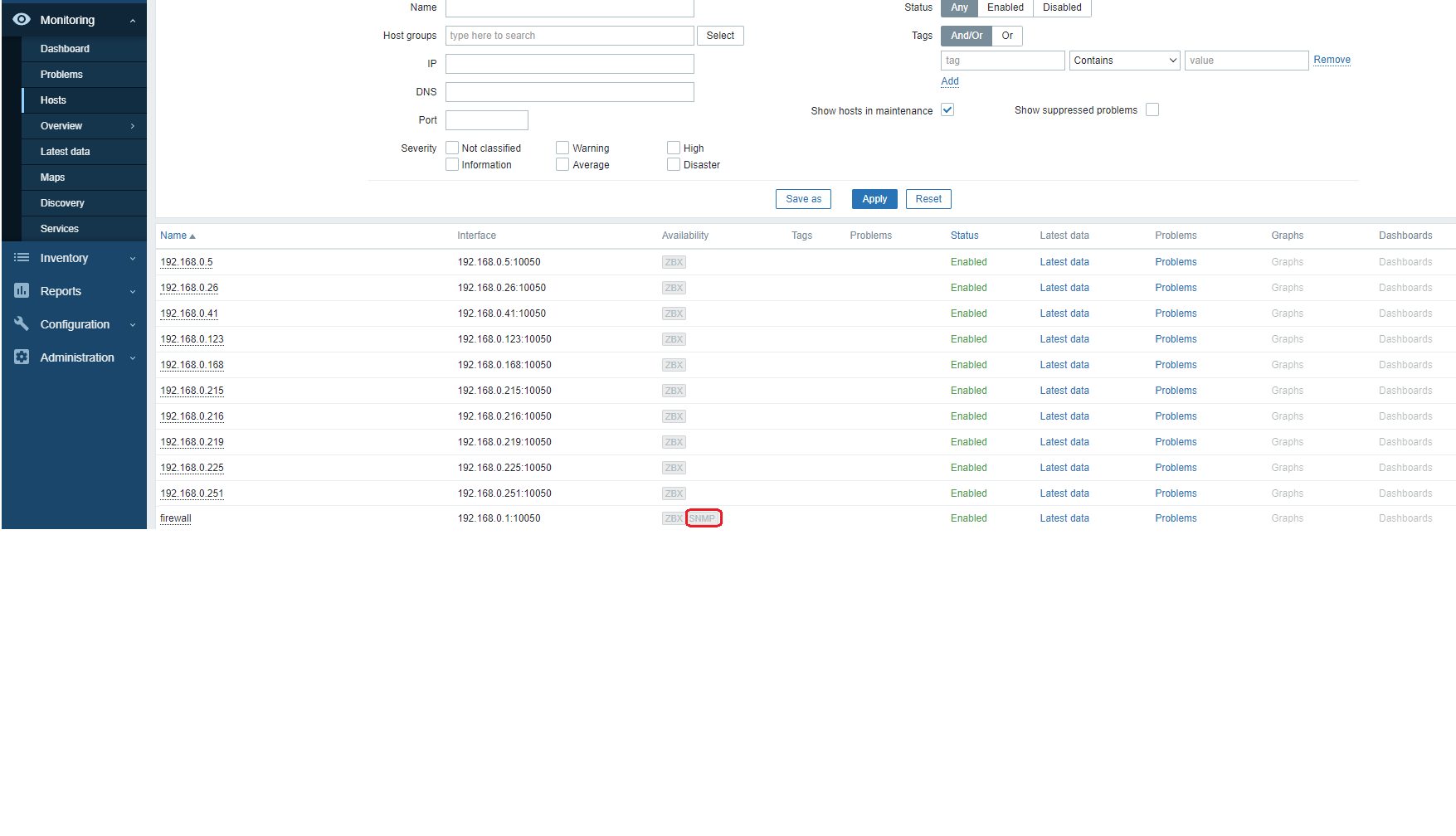

    I have installed (not built) Zabbix 5.4.8.1 onto CentOS 8 and cannot get SNMP monitoring to work. Under the Availability Column , SNMP is greyed out for hosts that I have manually added with SNMP check and for those that have been found via discovery (Where I have added SNMPv1 as a check), there is no SNMP against it.
    - When running a tcpdump, I do not see any snmp queries going out at all, whether during discovery or during a manual host add
    - I can snmpwalk the target hosts without any issues
    - There are no errors in the logs
    - sudo is setup to allow all commands (nmap is being executed correctly when I select "Discover Operating System")
    - The following snmp libs are installed
    -- net-snmp-utils-5.8-22.el8.x86_64
    --net-snmp-5.8-22.el8.x86_64
    --net-snmp-perl-5.8-22.el8.x86_64
    --net-snmp-libs-5.8-22.el8.x86_64
    --net-snmp-agent-libs-5.8-22.el8.x86_64

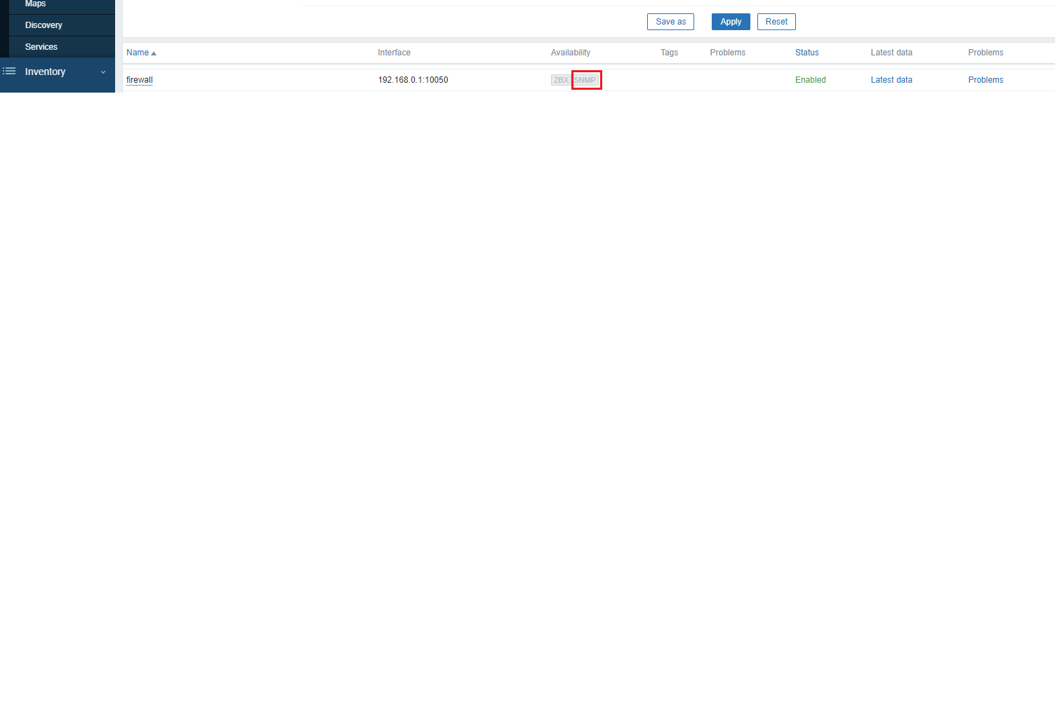

    The one here in red was added manually but no snmp query is made to the target ip.

          Have you read the documentation for your version on how "availability" is calculated?
          in particular the "Unknown interface status" section?
          Your first post showed a graphic of a list of hosts that had presumably been discovered; the default interface on all of the hosts is the agent interface (not SNMP). Is that your intent?
          You didn't show the full host view for any of the hosts (that I can see; apologies if I'm wrong and you did include it, viewing graphics from this forum doesn't work very well with latest Firefox browser), so I can't tell if any of the hosts even have an SNMP interface defined. For one of the discovered hosts that you would like Zabbix to poll via SNMP, does the host have an SNMP interface defined within Zabbix?

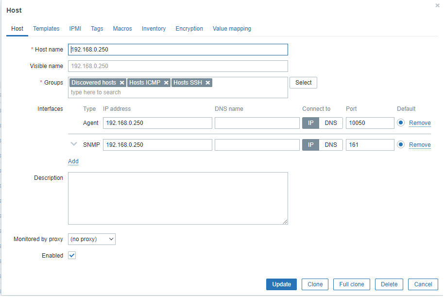

            Hi Tim, are you referring to this config item ? Interface as added as v1 with a community string
            No matter what I do, I don't see any SNMP queries (when using tcpdump) heading for the target IP

            • tim.mooney
              • Dec 2012
              • 1436
              I was indeed referring to that view. I wanted to make sure you actually had a SNMP interface defined, and you do.
              So your discovery process is finding hosts, and it's defining an agent interface (the default) and an SNMP interface.
              That much just defines a host and a couple of ways to query it, but it doesn't actually tell Zabbix to poll it. For that, you would typically have the discovery process assign templates (which contain items, some triggers, possibly graphs etc.) to each discovered host.
              So, what templates is the discovery process assigning to the host? From the view you show above (the "Host->Host" view), it's just the next tab over (Host->Templates).
