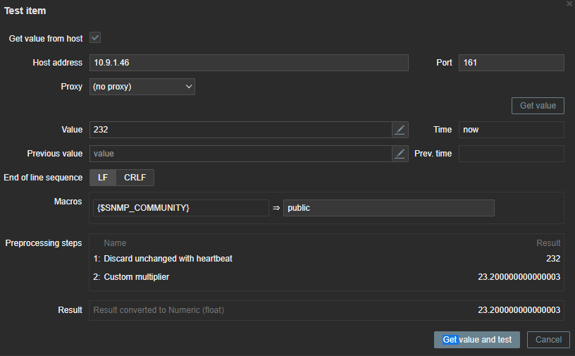

    Hello
    I am trying to convert a float value by multiplying with 0.1
    But if the value is 232, the result is 23.200000000000003
    I need to get 23.2 as result. Is there any sane way to do it?
    Thanks!
    23.200000000000003

    Hmm does anybody know how to convert values without strange numerical artifacts?
    • yurtesen
      • Aug 2008
      • 130
      Ended up using javascript
      return (value*0.1).toFixed(1);
