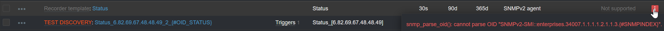

    1. in template T, I added an item, which SNMP OID= SNMPv2-SMI::enterprises.34007.1.1.1.1.2.1.1.3.{#SNMPINDEX }. Host has this item created, but can not parse oid, because {#SNMPINDEX} is not interpreted as a macro. I did found a way to store {#SNMPINDEX} in a macro to reuse it in the template.Click image for larger version

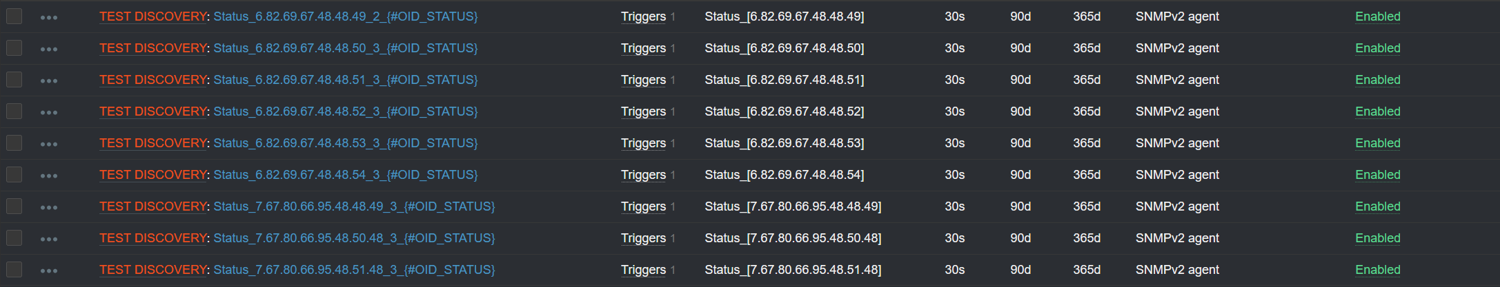

    2. in template T, I added a new discovery rule R2, which create item with the same oid that in case 1.. In this case, things are more correct, but an issue is present: by doing this, discovered host as 9 items: the 9 results of snmpwalk. What I wanted was just add the item located in SNMPv2-SMI::enterprises.34007.1.1.1.1.2.1.1.1.6.82.69.67. 48.48.49Click image for larger version
