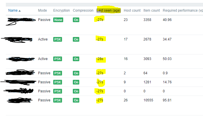

    Zabbix Proxy Last seen (age) is negative
    i have on my Zabbix system a number of Zabbix proxy and it show me on all the zabbix proxy the Last seen (age) as a negative number (as you can see in the photo below).
    is this ok and normal? if not please suggest how to fix it because i remember that it was not like this.

    Hello, I have the same probleme, did you solve it ?
      Do you have time synchronization in place?
      • abz
        • Oct 2021
        • 7
        Thanks for your reply, i resolved my issue.
        I didn't have the same time schedule on the server side and on the proxy side.
        On the proxy side, everything was fine.
        On the server side, I had to modify my NTP server, which was 3 min early.
        I was able to check this using the command: timedatectl
        and the line :
        [XXXXXX@XXXXXX-Server ~]$ timedatectl
        Local time: Mon 2023-10-23 14:31:09 CEST
        Universal time: Mon 2023-10-23 12:31:09 UTC
        RTC time: Mon 2023-10-23 12:31:09
        Time zone: Europe/Zurich (CEST, +0200)
        System clock synchronized: no
        NTP service: active
        RTC in local TZ: no
        Modification of /etc/chrony.conf configuration
        I added a line with my NTP server.
        I restarted my service
        sudo systemctl restart chronyd.service
        then the line changed to yes:
        "System clock synchronized: yes"
        I hope it helps.​
