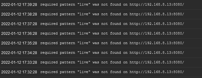

    Guys need help. Making a web scenario, and i have a problem with "Required string".
    I set up everything as in the instructions but I got an error "Required pattern "live" was not found on. "my web site""

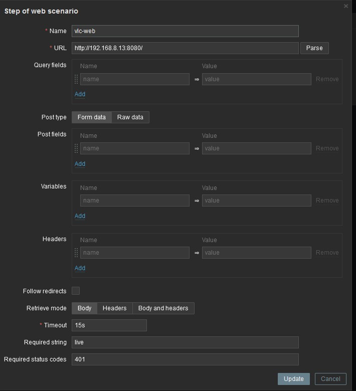

    I am attaching a screenshot settings. (Screenshot 1)

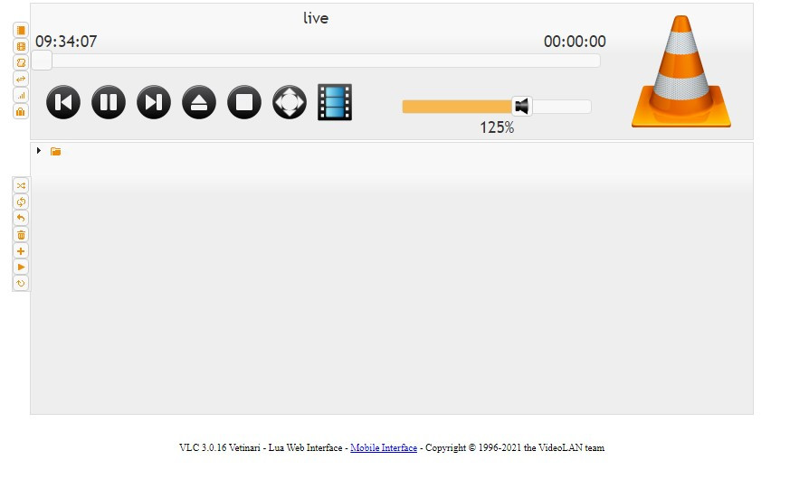

    I have the web page vlc-player (Screenshot 2), where I am monitoring the line "live". If playback stopped, then "life" will be disappear, then will be alarm and etc...

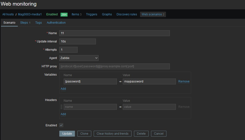

    The problem is that zabbix doesnt see this line, i mean "live" (Screenshot 3).

    Just a wild guess, but maybe you should not check for 401 return code...
    • Welcome_to_the_jungle
      • May 2019
      • 56
      its doesnt matter, 401 or 200, if i choose code 200, i receive message
      "response code "401" did not match any of the required status codes "200""
        • 4970
        401 is "Unauthorized". I guess you are not getting any page at all to search for "string"...

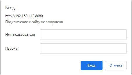

          I have autherazation page (screenshot1)
          I'm set up Scenario page(screenshot2), where i declare a variable {password} and make value my real password? right?
          My service havent login, just password, it is web interface vlc-palyer.

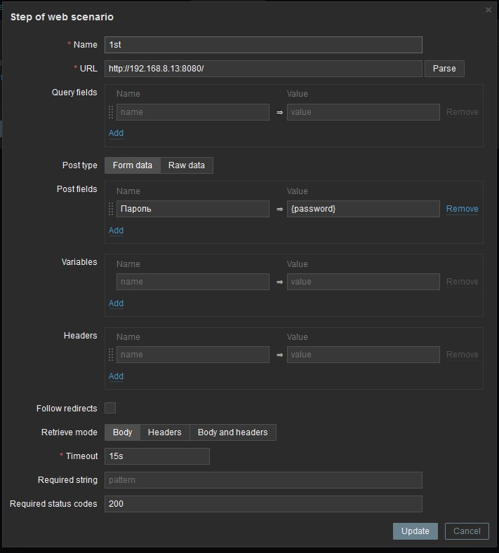

          Well, on the step 1 in "Post field" in the field "name" I enter what? Name of botton on the web site? Or something else?
          In the field "value" name of viriable? (Screenshot3)

            I don't know that vlc thing, but I guess you need to enter password under "authentication" tab. Probably selecting basic auth or something...

              i tryed it, unfortunately it didn't help
