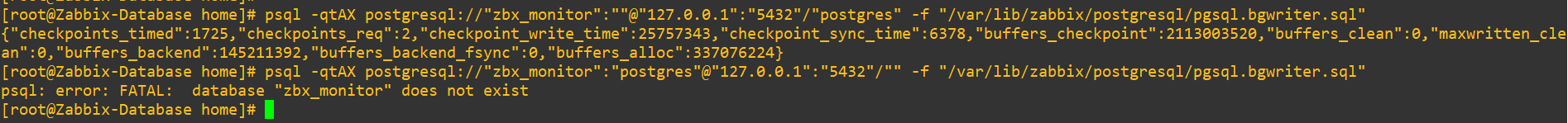

      UPDATE: The problem has changed slightly. I changed the pg_hba file so that the authentication error does not occur, but the template seems to read the macro incorrectly. It looks like it just assigns them one by one, as you can see in the attached picture.

        What happens if you switch places for PG.USER and PG.DB in key?
        Userparamter should be like this?
        UserParameter=pgsql.bgwriter[*], psql -qtAX postgresql://"$3":"$4"@"$1":"$2"/"$5" -f "/var/lib/zabbix/postgresql/pgsql.bgwriter.sql"
        so if we expand it with data currently given... "psql -qtAX postgresql://"{$PG.USER}":"{$PG.DB}"@"{$PG.HOST}":"{$PG.POR T"/"" -f "/var/lib/zabbix/postgresql/pgsql.bgwriter.sql"" Is that somehow executable from command line, if you place correct values there?
        • KPiatek
          • Jan 2022
          Thank you for your response and suggestion. Something has moved. I didn't change anything in the template, but I tried looking for the order according to what you wrote. And it worked!
          You suggested this:
          psql -qtAX postgresql://"{$PG.USER}":"{$PG.DB}"@"{$PG.HOST}":"{$PG.POR T}"/"" -f "/var/lib/zabbix/postgresql/pgsql.bgwriter.sql"
          Unfortunately it failed.
          However, when I changed the order to:
          psql -qtAX postgresql://"{$PG.USER}":""@"{$PG.HOST}":"{$PG.POR T}"/"{$PG.DB}" -f "/var/lib/zabbix/postgresql/pgsql.bgwriter.sql"
          This obtained the data. Now the question is where should I replace it to make the whole template work.
          In the template files (.conf and .yaml) I have in zabbix_agentd.d (on the node with DB and agent) everything seems to be correct. And the linked template on Web is Template DB PostgreSQL by user parameters. So the problem occurs somewhere around the templates.
