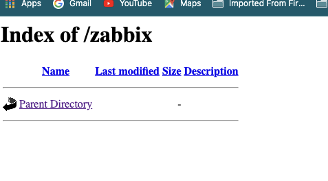

    kindly assist me on the error i'm getting, someone has installed zabbix on one of our servers and the server is sitting on the dmz zone. When i try to access as the service is ruuning i get the following error attached.

    Pic looks like no frontend files are installed. You just see empty directory listing.
    • mduduzi
      mduduzi commented
      cyber when i run sudo apt list | grep zabbix
      zabbix-agent2/focal 1:5.0.20-1+focal amd64
      zabbix-agent/focal,now 1:5.0.20-1+focal amd64 [installed]
      zabbix-apache-conf/focal,now 1:5.0.20-1+focal all [installed]
      zabbix-frontend-php/focal,now 1:5.0.20-1+focal all [installed]
      zabbix-get/focal 1:5.0.20-1+focal amd64
      zabbix-java-gateway/focal 1:5.0.20-1+focal all
      zabbix-js/focal 1:5.0.20-1+focal amd64
      zabbix-nginx-conf/focal 1:5.0.20-1+focal all
      zabbix-proxy-mysql/focal 1:5.0.20-1+focal amd64
      zabbix-proxy-pgsql/focal 1:5.0.20-1+focal amd64
      zabbix-proxy-sqlite3/focal 1:5.0.20-1+focal amd64
      zabbix-release/focal,now 1:5.0-1+focal all [installed]
      zabbix-sender/focal 1:5.0.20-1+focal amd64
      zabbix-server-mysql/focal,now 1:5.0.20-1+focal amd64 [installed]
      zabbix-server-pgsql/focal 1:5.0.20-1+focal amd64
