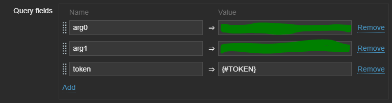

    2. it's an HTTP agent so I parse the URL, which is something like: http://hostname/aaaa/bbbb/cccc/dd/ff...token=MY-TOKEN, and in this token part, I did like this:

    That's all. But it's not working... I don't know why, but I receive a return that my http agent item prototype is not receiving the correct token, it's invalid. It seems that it's not recognizing my token macro

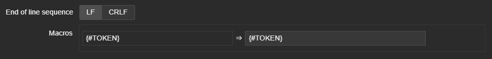

    Could you show how you set the LLD macro extraction in discovery?

      You mean this?
      I've checked my prototype item and I think it's not recognizing the macro... It's like this:
