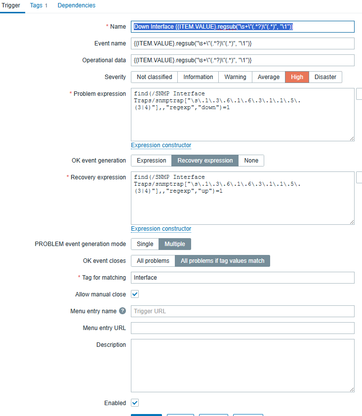

    I use SNMP polls and SNMP traps in our Zabbix system, but they works independently.
    I would like to force these functions work together. I found some strange solution:

    I can't found any information on the net how to set trigger active (in problem state) and how to fire it manually (I know, that when trigger have solution expression and not problem expression only - it holds last state, up to read opposite state of poll). Is this possible?
    Or something similar, simple?

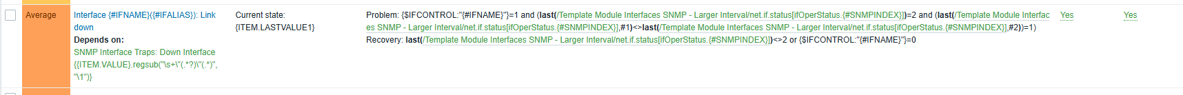

        Hi!
        I solve this using dependecy.
        it is easy pretty much. alert from polling interface Operational State is depemdable of snmp trap for the same interface .so if trap comes thsi poll alert will never trigger.
