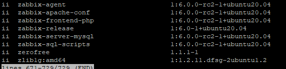

    Hello!
    Can you help me here? I have installed the Version 6.0.0r2, but somehow i cant upgrade to the LTS Version...
    What am i doing wrong?
Name:	Screenshot 2022-02-25 125410.png

    What error message are you getting when you try to upgrade?
    Does the released version of 6.0.0 use a different 'zabbix-release' package? If so, do you have to install that first and then do some kind of refresh operation for apt/dpkg/whatever?

      You'll find correct repos from here:
      Zabbix is being downloaded over 4 000 000 times every year for a reason. Download and install Zabbix for free and try it yourself!

        Hello!
        I get no error Code, just no Update
        So i think i have to remove all the Zabbix repo links and put in the new ones?
        tikkami The crazy thing is that when i get the new repo it just edits the one you can see in the picture, not all the other ones i have...
        I have to test it out a bit.
