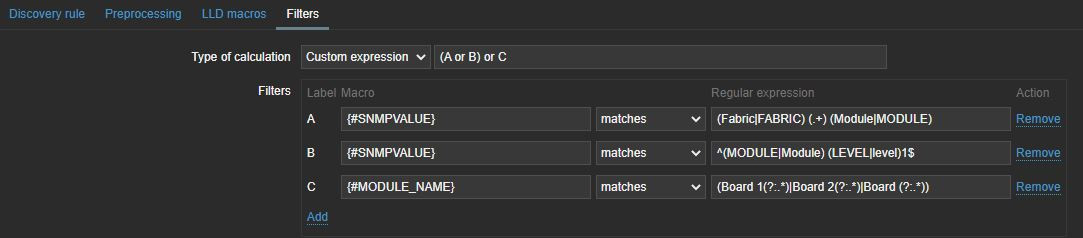

    I found the way to discover them by adding a filter in Module Discovery/filter:

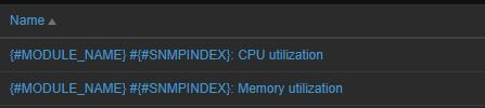

    Another trick: when supervising an HPE 5130 stack, with the same Template Net HP Comware HH3C SNMPv2, you cannot get the CPU and Memory graphs for all stack members, because all boards got the same name from the OID 1.3.6.1.2.1.47.1.1.1.1.2, they all are just called 'board', so I modify Module Discovery/Item prototypes and Module Discovery/Graph prototypes names this way:
    Click image for larger version  Name:	Capture.jpg Views:	0 Size:	11.1 KB ID:	440603
    So now I get all my stack members CPU and Memory graphs, the only problem is I don't have Board1, Board2 etc as graph name but Board #192, Board #210 etc. Maybe there is a way to modify item's name on the fly, I am still working on it.

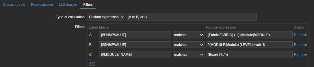

    Click image for larger version  Name:	Capture.jpg Views:	1 Size:	15.1 KB ID:	440605
    This second trick is not needed for a FF7910, so make sure to make different templates for 5130 or for FF7910
