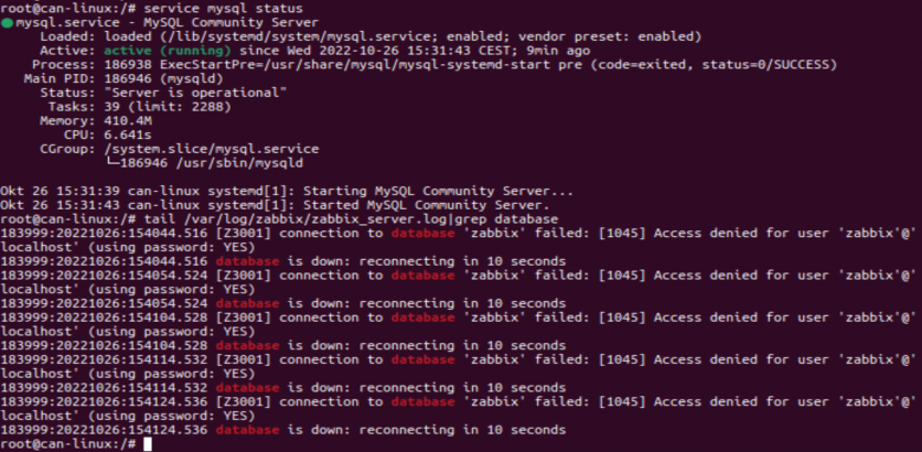

            • ckdmr
              • Oct 2022
              Hi All,
              I have the same output when trying to install Zabbix to VM Ubuntu 22.04
              I see in the logs it says the server is down and could not connect via Zabbix user but I am able to log in to the MySQL server
              any idea would be appreciated. Thanks

              root@can-linux:/# tail /var/log/zabbix/zabbix_server.log|grep database
              183999:20221026:154044.516 [Z3001] connection to database 'zabbix' failed: [1045] Access denied for user 'zabbix'@'localhost' (using password: YES)
              183999:20221026:154044.516 database is down: reconnecting in 10 seconds
              183999:20221026:154054.524 [Z3001] connection to database 'zabbix' failed: [1045] Access denied for user 'zabbix'@'localhost' (using password: YES)
              183999:20221026:154054.524 database is down: reconnecting in 10 seconds
              183999:20221026:154104.528 [Z3001] connection to database 'zabbix' failed: [1045] Access denied for user 'zabbix'@'localhost' (using password: YES)
              183999:20221026:154104.528 database is down: reconnecting in 10 seconds
              183999:20221026:154114.532 [Z3001] connection to database 'zabbix' failed: [1045] Access denied for user 'zabbix'@'localhost' (using password: YES)
              183999:20221026:154114.532 database is down: reconnecting in 10 seconds
              183999:20221026:154124.536 [Z3001] connection to database 'zabbix' failed: [1045] Access denied for user 'zabbix'@'localhost' (using password: YES)
              183999:20221026:154124.536 database is down: reconnecting in 10 seconds
              root@can-linux:/#

                • 5002
                It says it cannot connect to DB called zabbix. it is not exactly same, when you just login to mysql without choosing any db...
                Have you created DB, granted access to user?

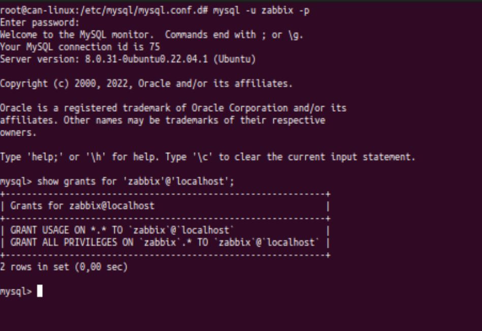

                • ckdmr
                  • Oct 2022
                  Hi Cyber,
                  Many thanks for your reply. yes, I figured out it is not the same issue after posting. I am new to this stuff. sorry for that.
                  here the output for access 'zabbix' user i guess?
