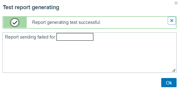

    Zabbix Server 6.0 - Report Sending failed for:
    I have recently installed Zabbix Server 6.0 LTS on my Ubuntu 20.04
    I want to create scheduled reports. For this purpose I executed the following commands:
    Install Zabbix Web Service
    sudo apt-get install zabbix-web-service
    Edit the zabbix_web_service.conf file
    sudo vim /etc/zabbix/ zabbix_web_service.conf
    Edited Allowed IP to AllowedIP = 127.0.0.1,::1, <MyIPAdress>
    Install chromium for Ubuntu
    1. sudo apt-get install libxss1 libappindicator1 libindicator7
    2. sudo wget https://dl.google.com/linux/direct/g...rent_amd64.deb
    3. sudo apt install ./google-chrome*.deb
    Edit the Zabbix_server.conf file
    sudo vim /etc/zabbix/ zabbix_server.conf
    Add StartReportWriters=1
    Add WebServiceURL = http://<MyDNSName>/report
    Enable and Restart the Zabbix Server, Zabbix Web Services
    sudo systemctl restart zabbix-web-service
    sudo systemctl restart zabbix-server zabbix-agent apache2
    sudo systemctl enable zabbix-server zabbix-agent apache2
    Go to Zabbix frontend -> Administration -> General -> Other ->
    Add Frontend URL http://<MyDNSName>/zabbix/zabbix.php
    I created a scheduled report from the Reports Tab and the recipients are the Zabbix Administrator. I have updated the Media type of the Zabbix Administrator with my email ID.
    Upon trying to send the report, the report generating test is successful but I get the error "Report sending failed for:[email protected]".
    What can I do to solve this error?

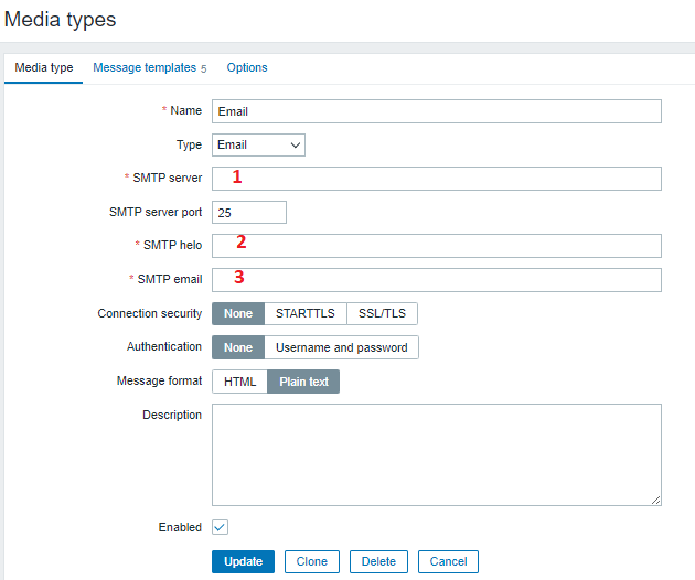

    next, Click image for larger version
Name:	media types.png
ID:	456039​you need setting smtp email
    Administration > Media Types > Email
