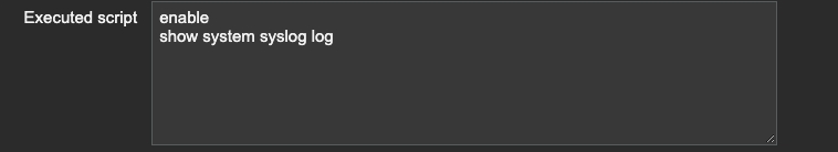

    Hello all,
    I'm trying to execute two commands at once using using Telnet checks. At this time i already have an existing item that telnets in my equipment and is able to grab the value. This new item I am trying to make it execute the command "enable" (to turn on privileged mode on) and then "show system syslog log"
    To sum up i have an existing item that works but when i try to create a new item with two commands i receive an error off that same equipment.
    Cannot find prompt after command execution: [4] Interrupted system call
    Any feedback would be appreciated

    According to the documentation (https://www.zabbix.com/documentation.../telnet_checks) after executing telnet command zabbix waits for the appearance of the "prompt".
    Either it doesn't recognize the return as prompt or the system doesn't really return prompt.....
    This is exactly what is written in the error.

      Appreciate the feedback. Yes it looks like it doesn't recognize the "#" prompt.
