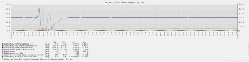

    I'm faily new to Zabbix and have been enjoying my time with it so far. I do have a recurring issue that is troublesome though.
    Usually every few weeks, but now twice in two days, The server stops processing data and I get a PROBLEM unreachable for 5 minutes for all my hosts, then a 5 minutes later or so, an OK.
    Here is all the relevant information and performance graphs that I can think of that might help.

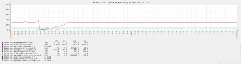

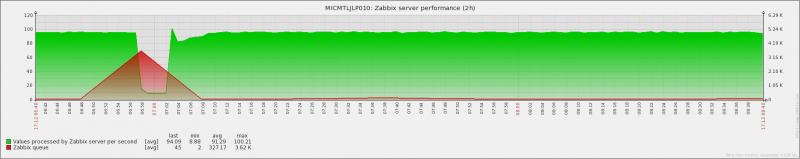

    The attached graphs show what zabbix saw in itself. I'm not sure what to make of it.

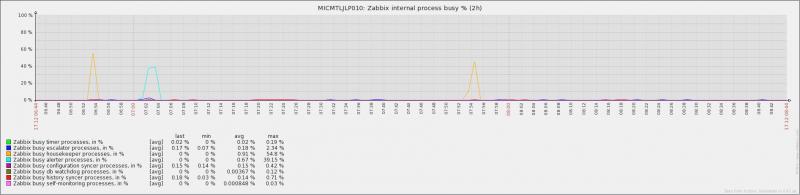

    Check the logs for housekeeping or some other high I/O process. Do you have "log long queries" set in mysql? If so, check that too.

      I do see a correlation with the housekeeping which is usually just before the end of the hours, every hour. But it isn't alwyas the case.

            I think the problem is caused by the delay in the external check script as shown by the timeout error message. I think each external check will tie up a poller processes while until this timeout occurs, if you have more external checks that wait than you have pollers, nothing else will happen.
            Does this script use DNS lookup? How many pollers are you running and how many of these scripts might be running concurrently?
