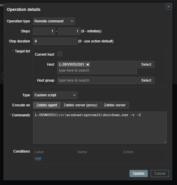

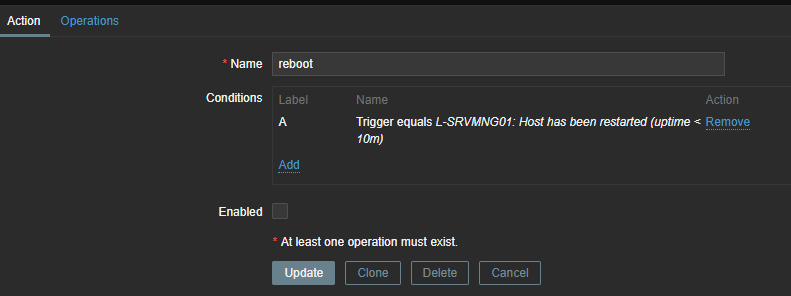

        As a test i made an Action to see if the remote reboot works, but i just got an error that says "Unsupported item key" . Do i need to enable remote commands on the zabbix agent?
