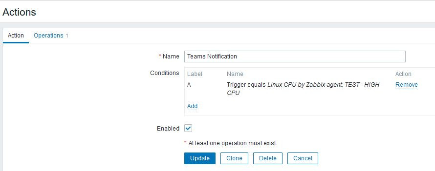

    I'm using Zabbix 6.0 and trying to send alerts to MS Teams.
    Firstly I set on "MediaTypes" page correctly our Teams webhook. And if I click "Test" button, a notification is successfully sending.
    Then I created an "Action" like below and added a trigger as a condition.

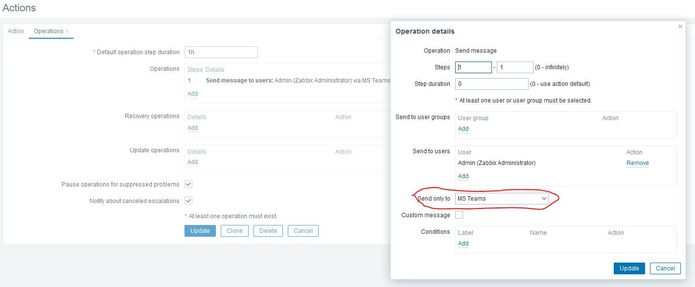

    After that, on the "Operations" tab, I filled the necessary informations like on SS

    From the Dashboard, I can see that alert has been created but it gives error, as you can see on SS

    What I'm missing on the "Operations" tab?

  • incama
    • Jan 2015
    • 67
    Does the user Admin have a media type MS Teams?
    • yatta
      • Feb 2022
      • 82
      Thanks, that solved the problem

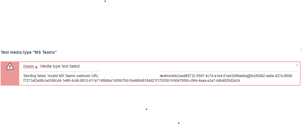

      • ponlorkbeang
        • Feb 2023
        Hello yatta, I had the issue when I tried to test connection with MS Teams. I follow the Zabbix guideline https://www.zabbix.com/integrations/msteams. Click image for larger version
