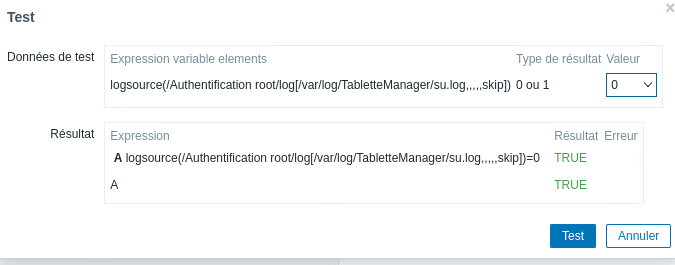

      So i tried to test like you said, with the expression "logsource(/Authentification root/log[/var/log/TabletteManager/su.log,,,,,skip])=0"
      i have 0 = true and 1 = false so i guess its not good, but in the latest data i do have my log.

        So until you are getting a "0", an event will be triggered.
        If you are getting a "1", the event will not be triggered. Seems to work correctly :-)
        But I think what you need is the opposite. The trigger should becomes "TRUE" if you are getting back a "1".

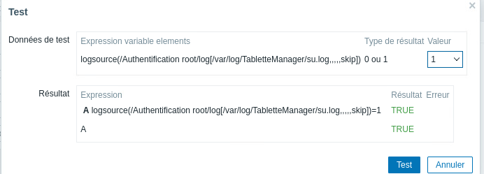

            so i tried like you said with 1 that need to return true
            AND i do have a notification on dashboard.
            we agree that we setup the trigger 1 because we need a match ? or did i miss understand something

              But important is, that the ITEM is returning a Numeric Value which is not 1 until somebody is executing the "su" command. Either your item is working with "text" or "numeric values". But you cannot combine them. Because if your item is configured to numeric value, it would lead in an error, of you are sending back a "text" instead of a numeric value.
              • Jack0
                • Mar 2022
                • 21
                Ok so here when the "su" is used it return 1 and this numeric value trigger the trigger (thx captain obvious) and i guess my mistake was that i wanted to combine the two values,
                Well really thanks for you help and your explanations, its really appreciated.
