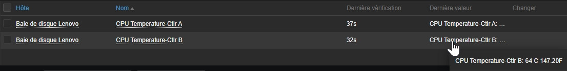

          When i go in last value, It is still the same result too:

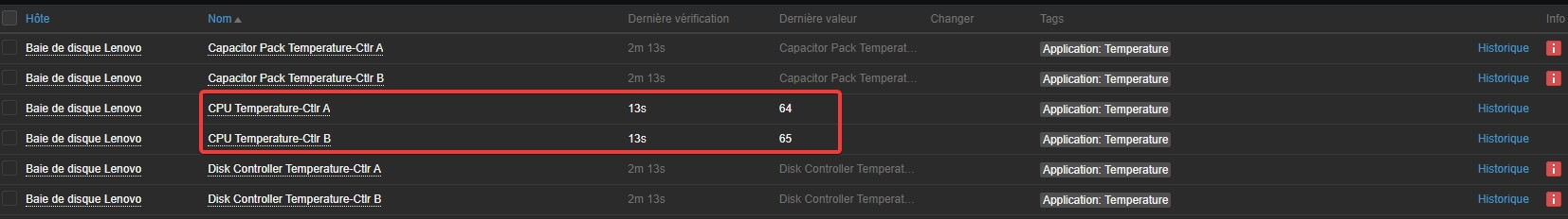

                  Click image for larger version  Name:	chrome_ngLXwXSKwh.jpg Views:	0 Size:	85.8 KB ID:	442761
