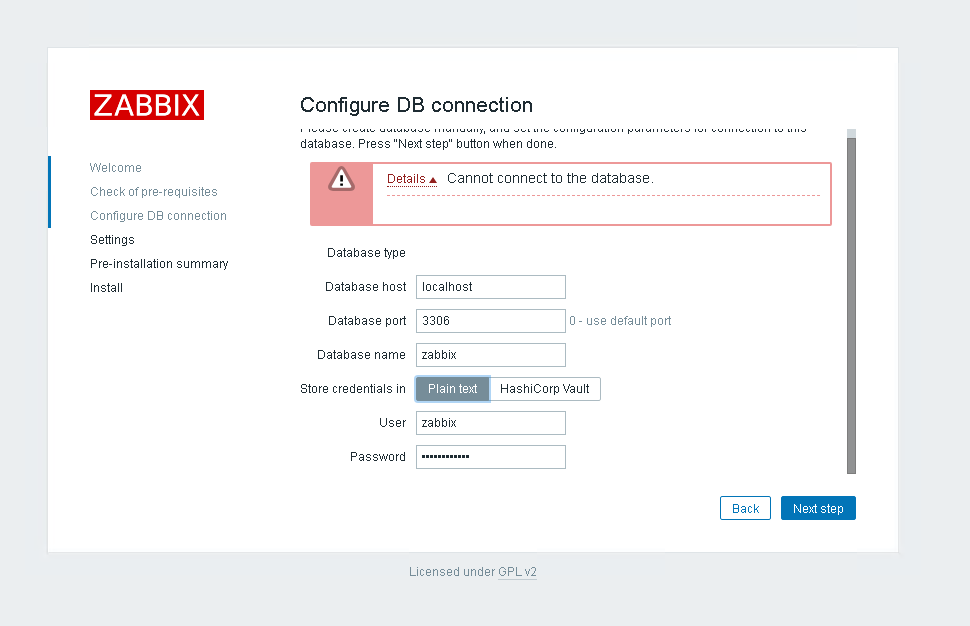

    I am starting an upgrade / fresh install of a Zabbix 6.0.3 on an ubuntu 20.02 server. i did get the database up and running then the Zabbix Server seems to be happy. But when I got to the web server it seem i cannot connect to the database. All of this is on a single box,, i am connecting to the localhost.
    When i look in the Apache logs i see an error:
    "Trying to access offset on value of type null in usr/share/zabbix/include/classes/core/Cookie Session.php"
    I am running php 7.4.1.
    Anyone have an idea what is wrong.

      Do you have all the necessary PHP extensions installed, including Ubuntu's PHP extension for connecting to a MySQL database?
      Did the web interface auto-fill "3306" for the port, or did you do that? If you did that, what happens if you change it to 0 (or blank it out completely)? Does that make a difference?

        I made the change to 3306, but was getting the same error with the default 0

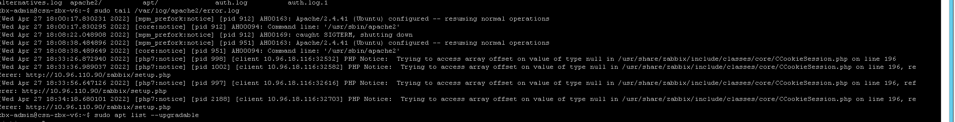

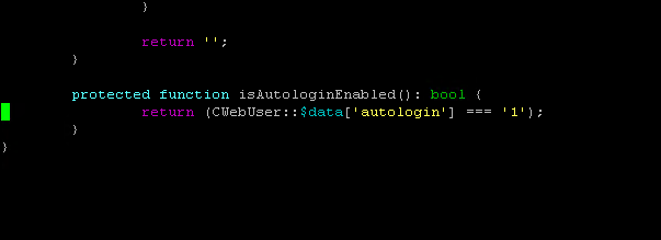

          I have traced this error down a little more but still have not found a solution, attached is a pic of the apache error log and the code it is pointing to.

                I am still looking for a solution for this issue Again i am running a Ubuntu 20.04.3 with PHP 7.4.3, Apache2, and MySQL 8.0.28. The server is running with very little effort. Will i try to run the web interface setup i get to the database page and get a message that I can not connect the database. I can use the zabbix user to connect using the mysql -uzabbix -p command line.
                In the apache error log i find the error message [phyp7:notice] Trying to access array offset on value of type null in /usr/share/zabbix/include/classes/core/CCookieSession.php on line 196.
                That line is in a function isAutologinEnabled():bool
