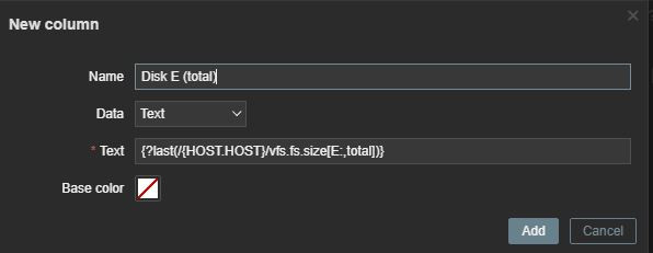

    Good afternoon.
    I ran into a problem, I wanted to make a selection in Top hosts, I add a column with a selection (data type of the Text field): {?last(/{HOST.HOST}/vfs.fs.size[E:,total])}
    But the data is not being uploaded...
    What am I doing wrong?

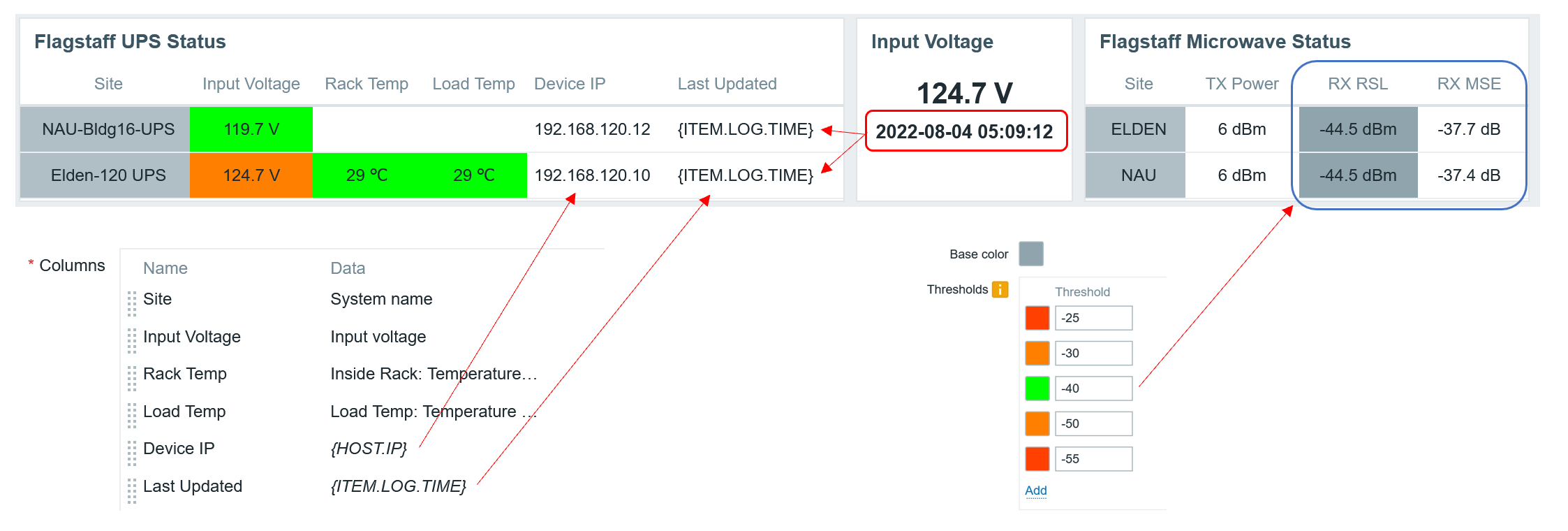

    I have a similar issue where some macro values show up in text fields (like {HOST.HOST} or {HOST.IP}) but others don't (like {ITEM.LOG.TIME}) when using the TOP HOSTS widget. As seen in the attached picture, I'm trying to duplicate the TIME data that can be placed in the ITEM VIEW widget to show the time the data was received on both sides of a microwave link using a TOP HOST widget.
    Also, it appears the THRESHOLDS in the TOP HOST widget only accept positive numbers as I'm trying to color code receive signal levels - which are negative numbers. The negative numbers show up in the base color and not the threshold color.
    I am new to Zabbix and not sure if I missed something in the documentation or if I'm trying to push the widget beyond what it's supposed to do.
    Any help/comments are certainly appreciated. THANK YOU
