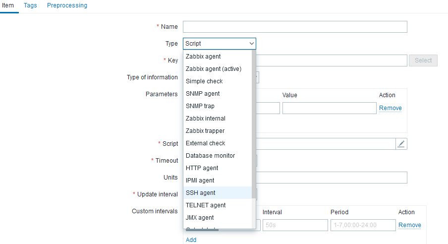

      Hi again! I created "/etc/zabbix/zabbix_agentd.d/hostnametest.conf" file and only Zabbix server(not on all servers, and I guess that's how it should be?), restarted agent on Zabbix server
      After that I'm trying to create an Item but not sure how to do. What should I choose?

        If you use "zabbix agent userparameters"... then it should be quite obvious, what the item type would be...
        Can be also " ... (active)"
        If you want to run it in all your servers, you need that config in all servers and also that script in all servers...
