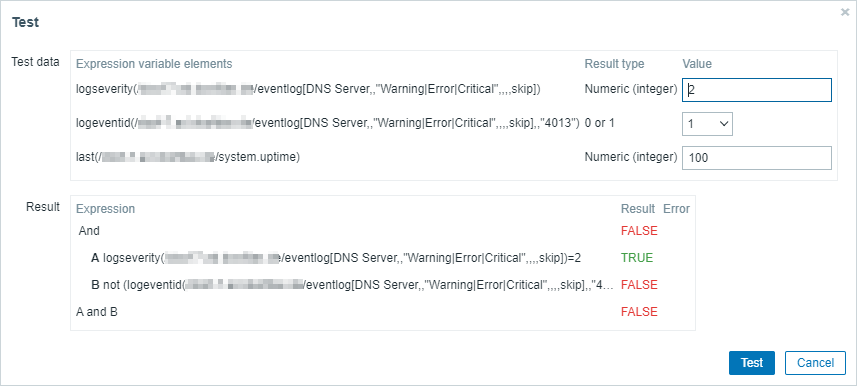

      I've tried the following (first, inexperienced thought):
      logseverity(/host/eventlog[DNS Server,,"Warning|Error|Critical",,,,skip])=2
      and not (logeventid(/host/eventlog[DNS Server,,"Warning|Error|Critical",,,,skip],,"4013")=1
      and last(/host/system.uptime)<120)
      Don't fire if event-id is 4013 und the system.uptime is less than 2 min.
      This trigger will also fire every 30 sec. after the system is up for more than 2 min. = first thought wasn't as good.
      Is it possible to take into account the time when the event occurred?
      I'm totally confused at the moment ...
      Thanks a lot!
      jb

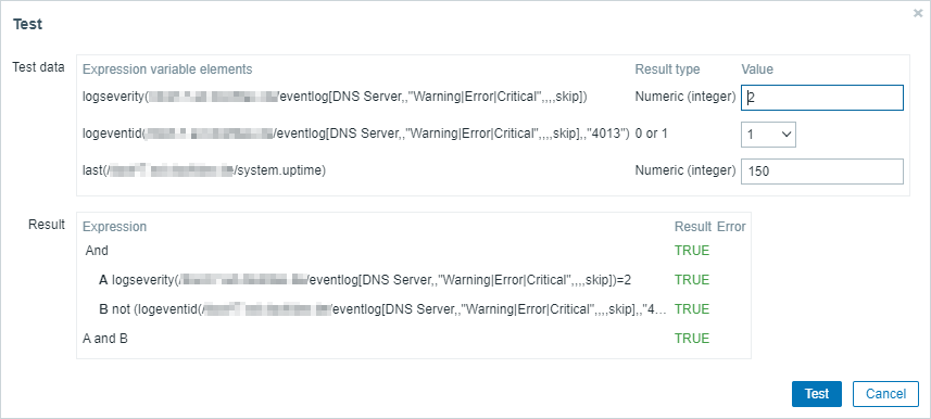

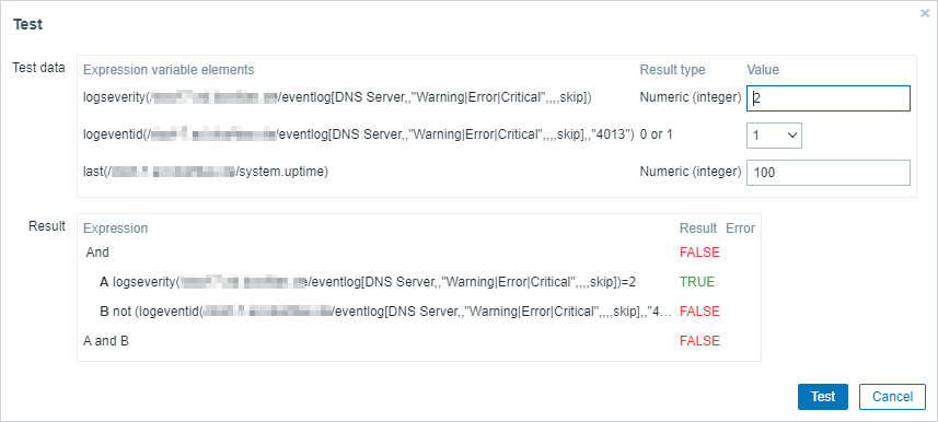

          Hm, if I test the expressions every seems to be okay:

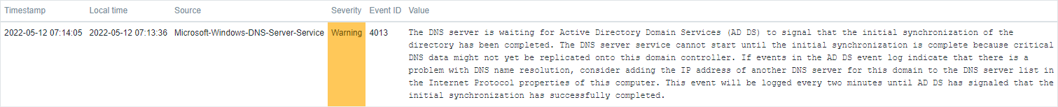

          The corresponding warning message exists only once:
Name:	2022-05-12 15_37_44-Window.png
          Unfortunately the trigger fires every 30 seconds the wohle day. Maybe because system.uptime is > 120 seconds?
          It seems like the engine doesn't recognize that the warning message has already been processed? How could this be corrected?
