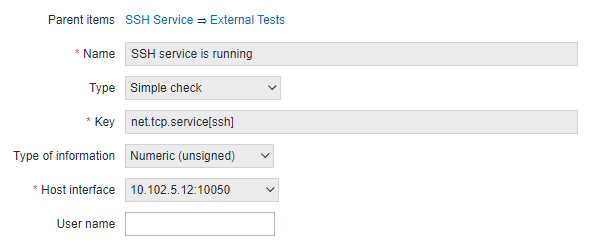

    I have Zabbix 6.0.4 on a RHEL 8.5 VM with three vNICs. I need to make extensive use of "simple checks" to monitor running services on devices with no agent installed.
    Trying to use simple checks to test the presence of SSH and LDAP services on my first few monitored devices all come up in '0' "Service is down" status even when I can confirm that those services are running and accessible from the Zabbix host.
    zabbix_get also shows the service as up but the Zabbix web GUI shows down?

    So, how does one actually execute external checks? The defined checks "SSH Service" etc all come up in Down state despite the type being "Simple check"

    FW-s allow ssh connections from server/proxy to that host? Simple check is initiated from server/proxy towards that host or defined IP/DNS name.
