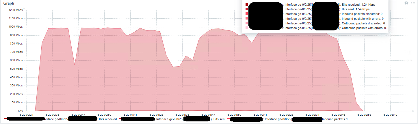

        Far from an expert here, but thought I'd chime in...
        I just experienced this 'slideshow' behavior myself building a dashboard of network interfaces. I got the 'slideshow' effect when I used the "Graph prototype" widget... With a stacked switch (96 line ports plus uplinks, virtual interfaces, vlans, etc) the slideshow effect was not much use so I changed to a widget type of "Graph."
        Then (scroll down to "Data set 1") I chose the switch in "host pattern" and a few useful items in "item pattern" (bits sent, bits received, error packets in and out, and discards in and out) for a single interface.
        For what it's worth, I'll probably move the errors and drops to a graph of their own as they're getting lost in the scaling of the bits in/out.

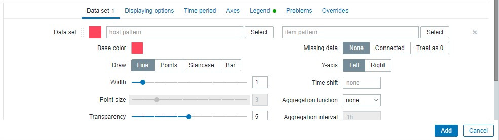

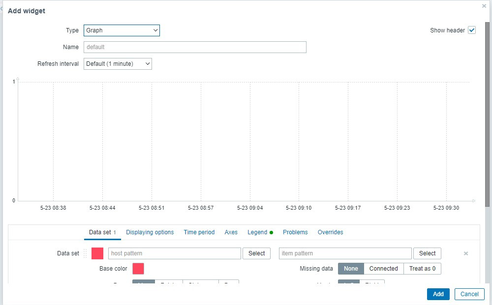

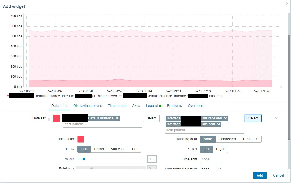

            Neither really...
            The host (switch) was discovered and the "ICMP Ping" template automatically applied. I added it to my "Devices/Networking" host group (no linked templates,) added the SNMP agent and credentials and then applied the template for the switch. All the LLD rules added interfaces and graphs as appropriate for the template but none of this has anything to do with the dashboard!
            I created a custom dashboard and added "GRAPH" widget (not "Graph Prototype" or "Graph (Classic),") selected the Data Set (switch device) and in "Item Pattern" I selected the interface bits in/out etc.
            Click image for larger version  Name:	graph 2.jpg Views:	0 Size:	50.1 KB ID:	444991
            Click image for larger version  Name:	graph 1.jpg Views:	0 Size:	72.9 KB ID:	444992
            Click image for larger version  Name:	graph 3.jpg Views:	0 Size:	109.0 KB ID:	444993
