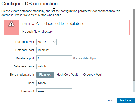

    Fresh install. Cannot connect to the database. No such file or directory
    Hello mates!
    On the step "Configure DB connection" I get an error with connection to DB (MySQL).
    I've edited /etc/zabbix/zabbix_server.conf wrote user,db and password. Also add mysql socket path.
    If I try to connect via console with zabbix user, login and pass works fine.
    I don't have any errors with connection in /var/log/zabbix/zabbix_server.log
    I can't understand where find the error. Please help!

      You are getting a Frontend error, not Server. So, you need to make sure your DB host, port, name, user and password are correctly set in this DB connection form.
      I assume you are using a standalone installation, but, if your Zabbix Frontend uses a different host than MySQL, make sure your DB and user can receive connections from different hosts.

        I couldn't figure out if it was a front or back error. There was nothing in the logs, even with zabbix extended debugging enabled. All database settings were made correctly and I could connect directly to the database in the console. The database was also created and imported during the initial installation.
        I've found solution. The problem was in php.ini config file with path to mysql socket. I changed today path to
        mysqli.default_socket = /var/lib/mysql/mysql.sock
        from
        mysqli.default_socket = /run/mysql.sock
        And finish installation.
        Thanks for help.
