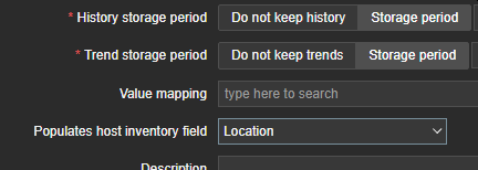

            • 4970
            Did you set your item to populate the field? Is your hosts inventory set to "Automatic" or "Manual" or "Disabled"?
            If its disabled, then I dont think it will populate....
            Click image for larger version  Name:	location.png Views:	0 Size:	11.6 KB ID:	445518
            • tashton
              • Apr 2022
              Thanks - Yep its set to Populate Location and Inventory has been set to Automatic.
