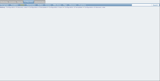

    On all of my templates if I try and open some discovery rules (such as interface or file discovery on windows templates) they I just just a blank grey screen. Has anyone else seen this?

    More information... It seems the rules I cannot open are the ones that had filters in them. All the ones that didn't use filters seem to open ok... Is it possible some of them didn't upgrade properly?
    Edited : I've tried importing some 2.4.X templates such as the OS_AIX one and on that I cannot open the discovery rules there so it's not a problem with the templates themselves I think.
    I've attached the screen I'm seeing. We're running on Centos 6 (2.6.32-573.12.1.el6.x86_64) with nginx as our web server.
    If i remove the filter (by exporting template, removing filter and re-importing) then I can edit the discovery rule until i re-add the filter where it goes back to not working again.
