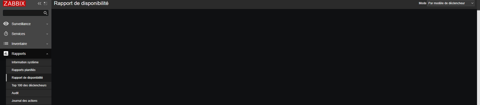

    I wanted to check the report sections of Zabbix, I went on Reports → Availability report.
    I displayed my triggers by hosts, everything was working then I clicked on the "By trigger template" on the top right of my screen and my page is constantly loading, I cannot do anything.
    Tried to switch back to the "By host" option, still loading doesn't do anything. I restarted the apache service, the zabbix-server , even rebooted my vm's...
    If anyone has got a solution, i will really appreciate it.
    Thank you a lot.

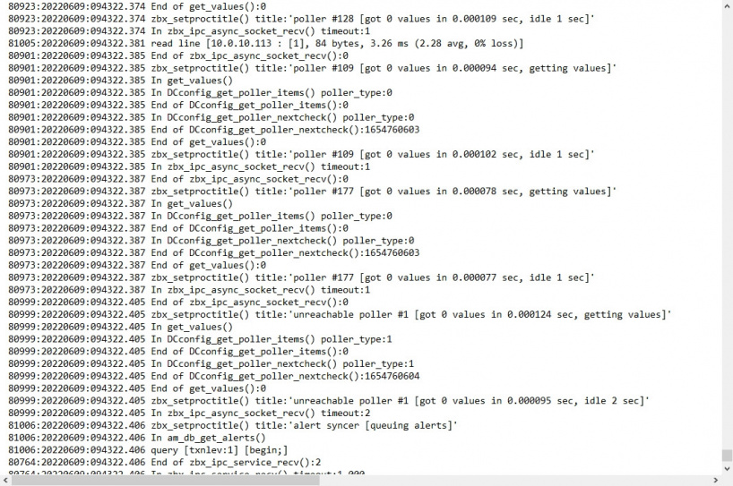

    Change DebugLevel parameter in zabbix_server.conf to 4:
    DebugLevel = 4
    then reload Zabbix server and try to reproduce the issue. Please, attach the log file to this post.
    • MonZabbix
      • Dec 2021
      • 19
      Hi vladimir_lv!
      Thank you for your quick reply.
      Here is the log file as requested.
      Preview of the file:

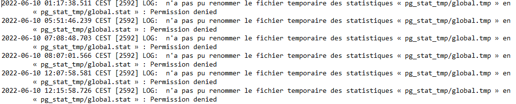

                          Checked postgresql logs and I find this error which i believe is unrelated to our issue:
                          could not rename the temporary statistics file "pg_stat_tmp/global.tmp" to "pg_stat_tmp/global.stat" permission denied
