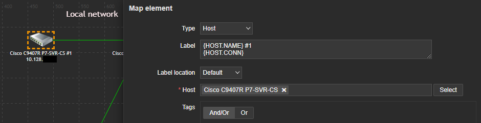

    Anyone ever putting temperature to display on the map? I can put the HOST.NAME (host name) and HOST.CONN (IP address of the host). Also I would like to display the temperature of the host below the label {HOST.CONN}. Anyone know the temperature label?

    RTFM!
    https://www.zabbix.com/documentation...ation/maps/map
    {?last(/{HOST.HOST}/you_temperature_key)}

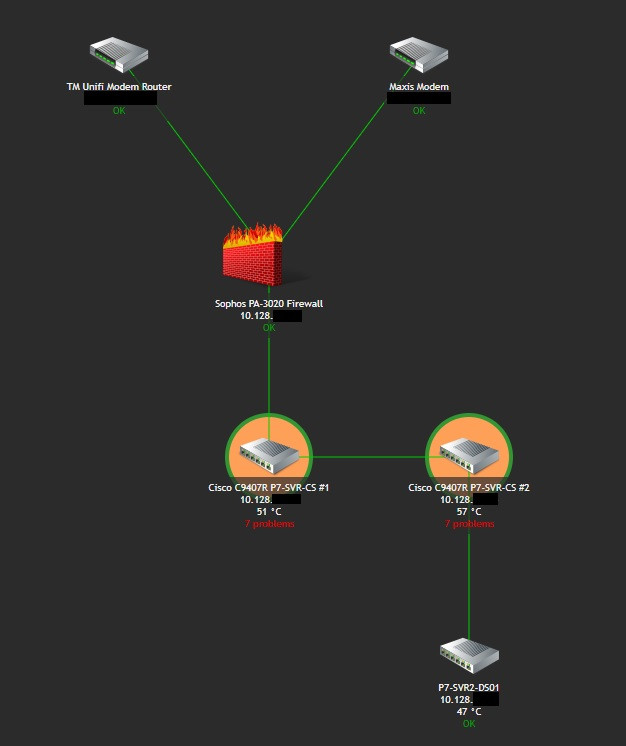

    • NGate-Jonathan
      • Jun 2022
      • 32
      Thanks for the guidance and I manage to make it work
