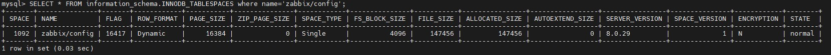

      Can you check if the table schema is really DYNAMIC? Just to be sure.
      SELECT row_format FROM information_schema.tables WHERE table_schema="zabbix" AND table_name="config" LIMIT 1;
      • pablix
        • Dec 2016
        Hi vladimir_lv!
        It seems to be dynamic:
        mysql> SELECT row_format FROM information_schema.tables WHERE table_schema="zabbix" AND table_name="config" LIMIT 1;
        | ROW_FORMAT |
        | Dynamic |
        1 row in set (0.00 sec)

                  One more query:
                  SELECT * FROM information_schema.INNODB_TABLESPACES where name='zabbix/config';
                  • pablix
                    • Dec 2016
                    Hi!
                    Sorry for late response.
