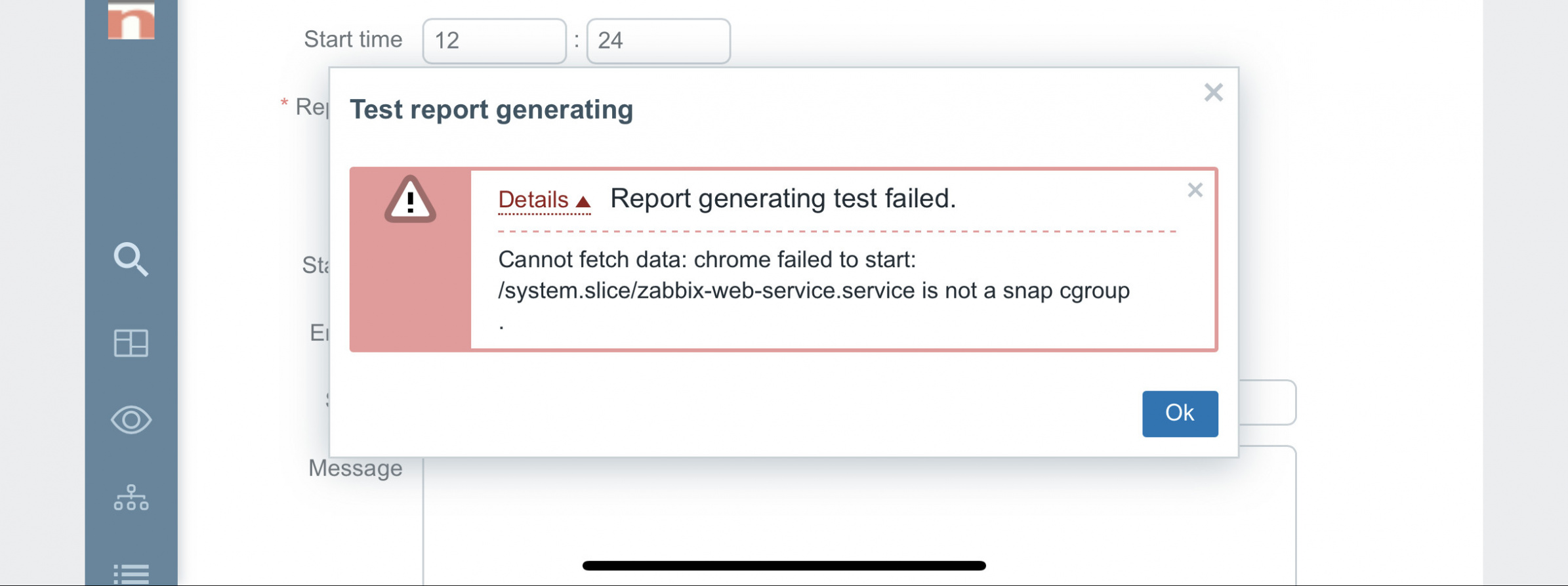

    • maitrikpatel3
      • Nov 2023
      Hi
      can you please help me on this

            • maitrikpatel3
              • Nov 2023
              Hi i given permission yesterday and after new error is coming
              • Cannot fetch data: chrome failed to start: /system.slice/zabbix-web-service.service is not a snap cgroup .
              ​Thanks for your reply

                  • gautefu
                    • Dec 2023
                    I have the exact same error as you maitrikpatel3.
                    Does anyone know how to troubleshoot or - preferably - fix this issue?
                    Thanks!
                    • MUCrisp
                      • Apr 2025
                      Click image for larger version  Name:	image.png Views:	1444 Size:	11.2 KB ID:	475506
                      Thanks!
                      After researching similar issues, I discovered users aren't part of the cgroup unless logged in. I did the following to keep the zabbix user logged in.
                      sudo loginctl enable-linger zabbix
