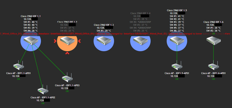

    How to hide the problem name in Map?
    I don't mind if it show <number> problems in the Map but I don't want it to show out the problem name or description. It show the problem name and it is very long so I feel so annoying. Look messy and text overlap each other when the object was side by side on the Map.

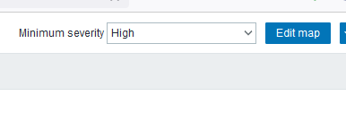

          • vladimir_lv
            • May 2022
            • 240
            Nope, I meant to choose monitoring severity High in Map. Then you will see problems with severity High or Disaster

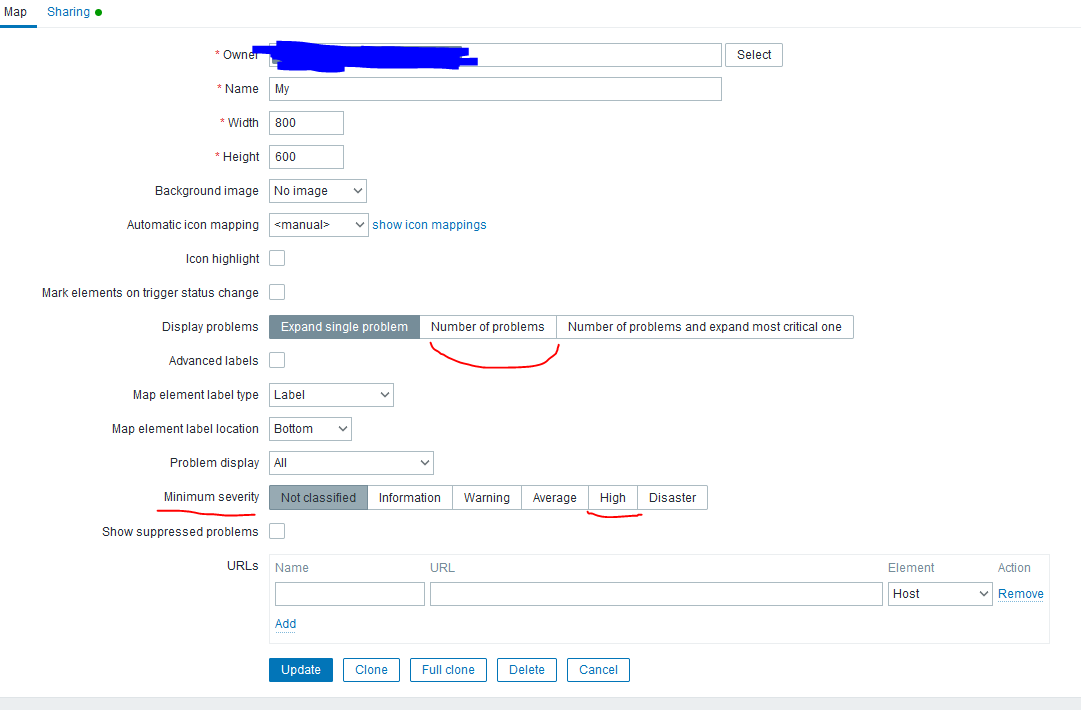

                    • vladimir_lv
                      • May 2022
                      • 240
                      I was wrong. You can change both "Severity" and "Display problems" on Map's properties. So, you can set a minimum severity of displayed problems to High or Disaster or just choose to display "Number of problems" only. It works fine for the widget.
