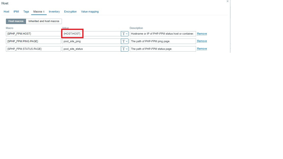

    I need to pass the hostname as a parameter to define a global macro, but unfortunately I can't do it.
    In previous versions, I used the {HOSTNAME} macro, everything worked, but it is deprecated and does not work in version 6.0.5.
    I noticed that these macro weirdness started after upgrading from version 6.0.4 to version 6.0.5.
    If I specify the real hostname, then everything works.
    Probably I misunderstood something, tell me how can I solve this?

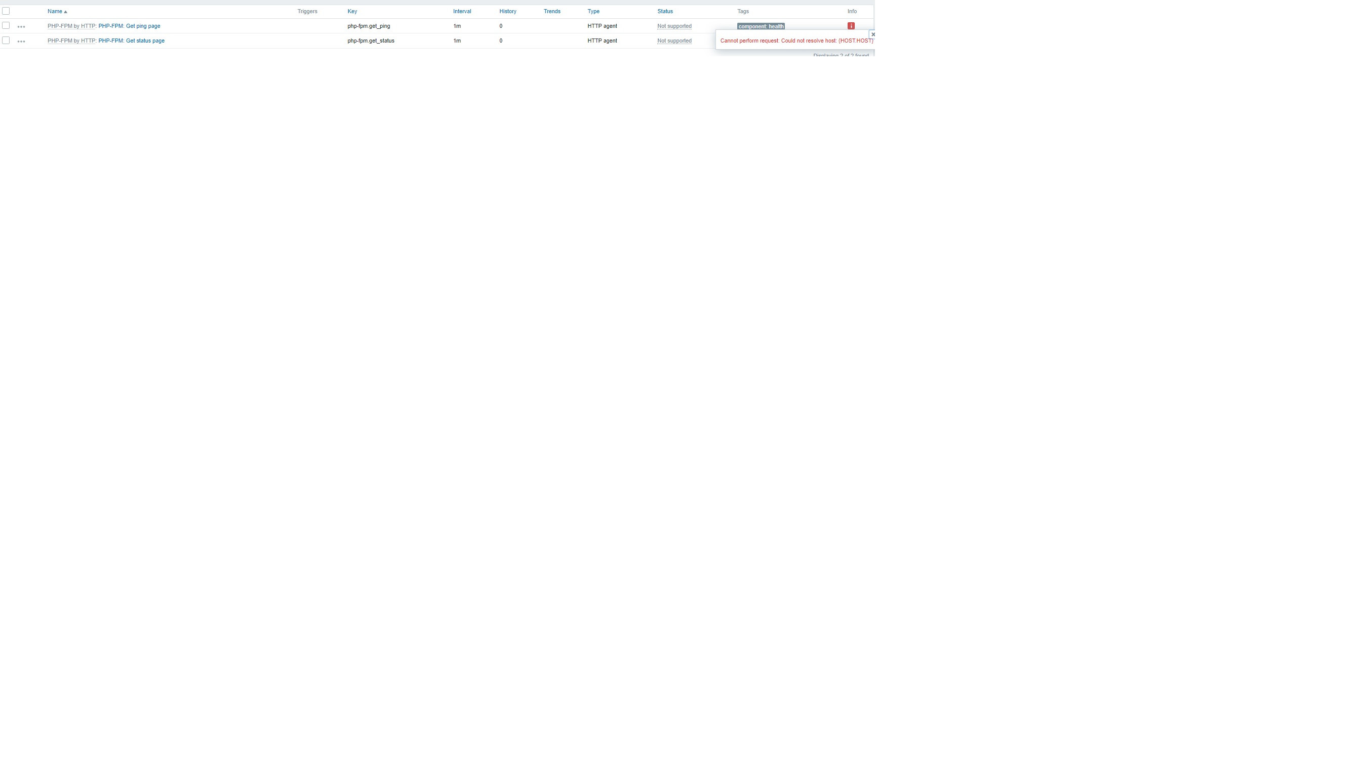

      It only works for me in item and trigger, but it doesn't work in host macros, see my PrnScr in the location.
      I tried: {HOSTNAME} {HOST.HOST} {HOST.NAME} throws an error. But it certainly worked before.
