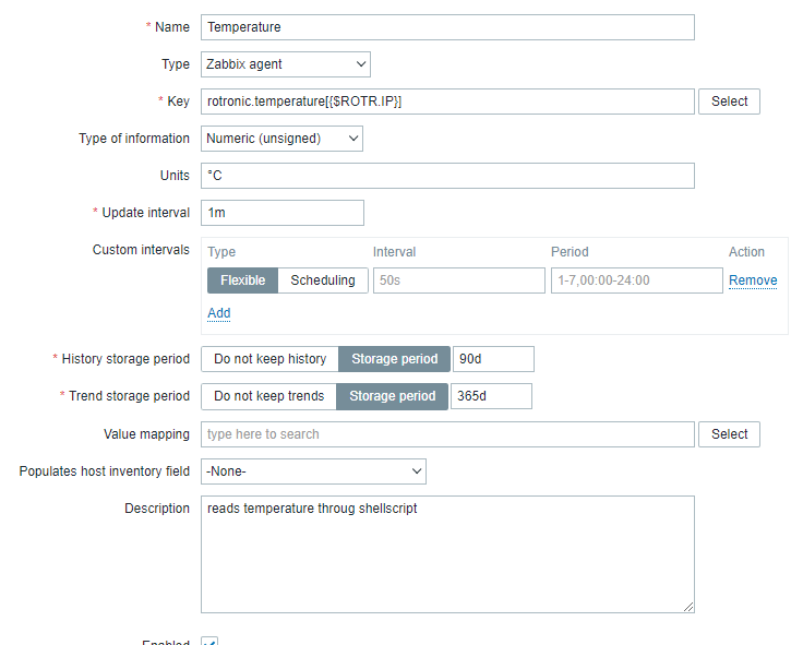

                          My item settings are:

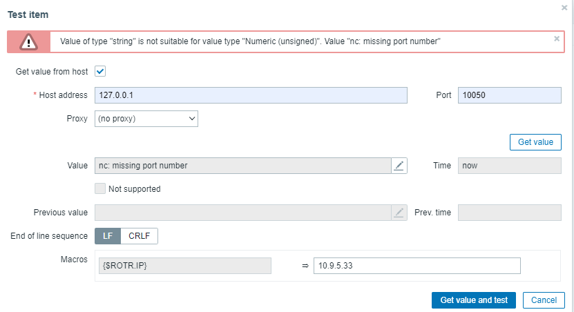

                          When I test the item i get this:
                          So it's quite clear that the information in the macro is not sent to the script.
                          The script does this: nc -w 1 IP PORT
                          If IP is not there, it thinks the port is the ip and says "nc: missing port number"
                          So zabbix does run the script, but the macro containing the IP is not parsed to the $1 in the userparameter, which looks like:
                          UserParameter=rotronic.temperature[*],/etc/zabbix/rotronic.sh -t -ip=$1
                          there is something going wrong between zabbix calling the agent to run the script and the parsing of the macro.
