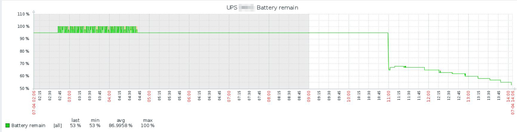

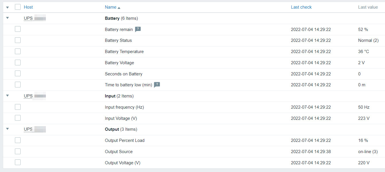

    When you get bored, or you want to make the management independent, then consider the option to supplement your UPS with compatible NetAgent SNMP card:
    NetAgentA NetAgentA is the latest in MegaTec series of SNMP cards. Forged with a more powerful CPU and kernel allows this model to do much more. Real-time Alert Troubleshooting Remote Control Learn More NetAgentA NetAgentA is the
    see GUI: http://megatec.com.tw/netagent9/std/...stemStatus.htm
    make sure the length of the card is compatible with slot in your UPS
    and see a chart of SNMP Agent card in zabbix with 'UPS_SNR.xml' template.
    template attached, perhaps you will change a template for your infrastructure.
