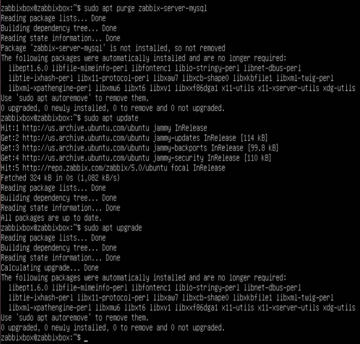

                  • dcoan
                    • Jul 2022
                    I was never able to install zabbix-server-mysql so it was not purged. I have done apt update/upgrade as well.
                    • Markku
                      • Sep 2018
                      • 1784
                      You have configured something incorrectly: jammy is the codename for 22.04.
                      So do you have 20.04 or 22.04?
                      lsb_release -a
                      Markku
                      • dcoan
                        • Jul 2022
                        We have a winner. I'm using 22.04.
